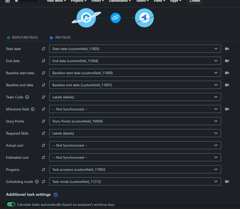

    Confirm that BigPicture is pulling estimates from the right field—typically Original Estimate. If it’s set to a custom or unused field, this could be the cause.
    1. Is there a specific place I would do this? I have checked app configuration but can’t see any field for original estimate (please refer to screenshot below).

  3. Estimation Source - Based on the screenshot you shared, everything looks good to me here. No red flags at first glance.
