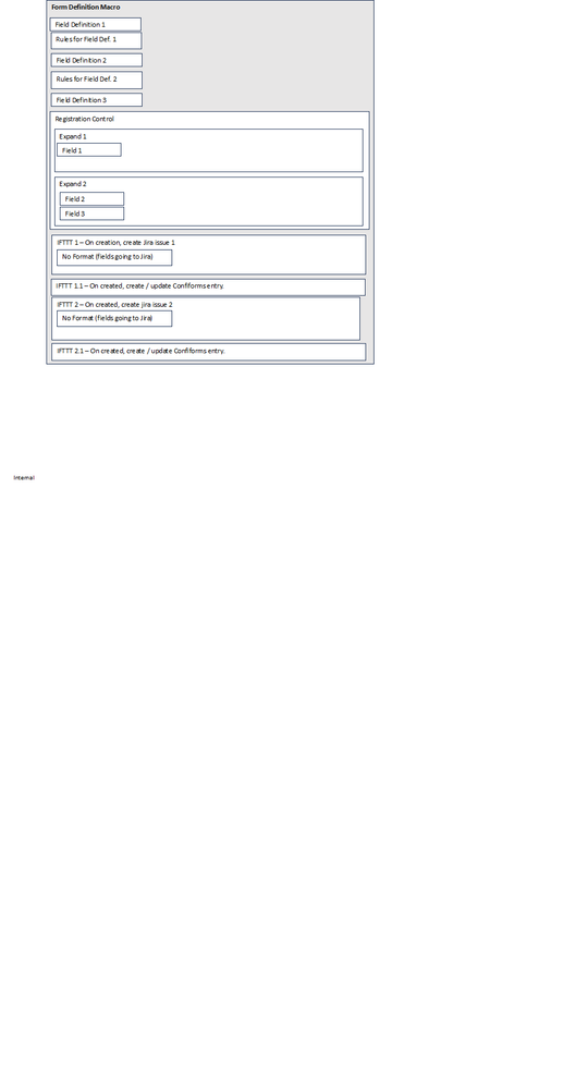

Thanks @Alex Medved _ConfiForms_ for your help with this. Both of my IFTTT's to create the issues and feed the JIra ID back to the form work, but only for the IFTTT's that are first. I've created a mock-up to demonstrate the set-up I've used. Are things in the correct order and placement?
What do you mean by this?
