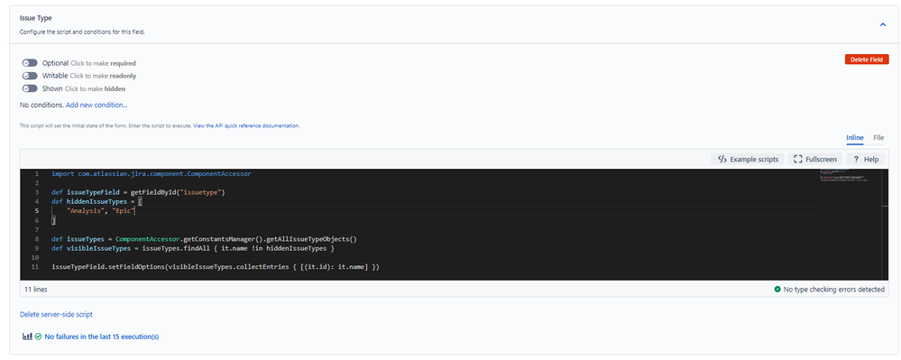

I don't have a condition. I have several issuetypes in my scheme and i want to hide some of them so that the other projects using the same scheme wont be affected. I also did the project mapping in the behavior.
def issueTypeField = getFieldById("issuetype")
def hiddenIssueTypes = [
"Analysis", "Epic"
def issueTypes = ComponentAccessor.getConstantsManager().getAllIssueTypeObjects()
def visibleIssueTypes = issueTypes.findAll { it.name !in hiddenIssueTypes }
issueTypeField.setFieldOptions(visibleIssueTypes.collectEntries { [(it.id): it.name] })

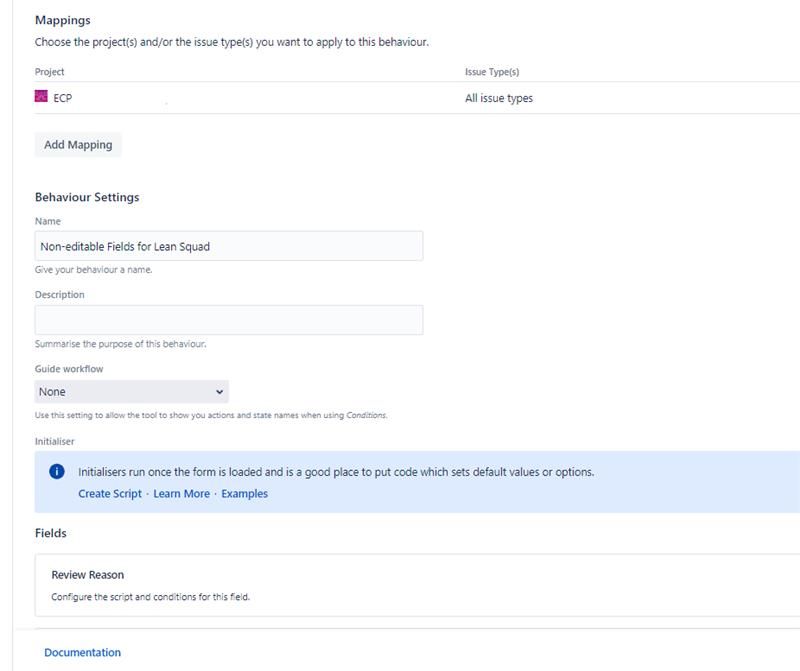

Please share a screenshot of your Behaviour configuration. I need this to check how you are associating your Behaviour configuration with the Projects and rerun the test in my environment.

Thank you for providing the screenshot.
I will test this in my environment and get back to you once I have an update.

I can confirm that the approach you are taking is incorrect based on the screenshot of the behaviour configuration you shared.
Instead of using a Server-Side Behaviour, you will need to use the Behaviour Initialiser to set the default options on the Issue Type since you are not depending on a field to update before triggering the Behaviour.

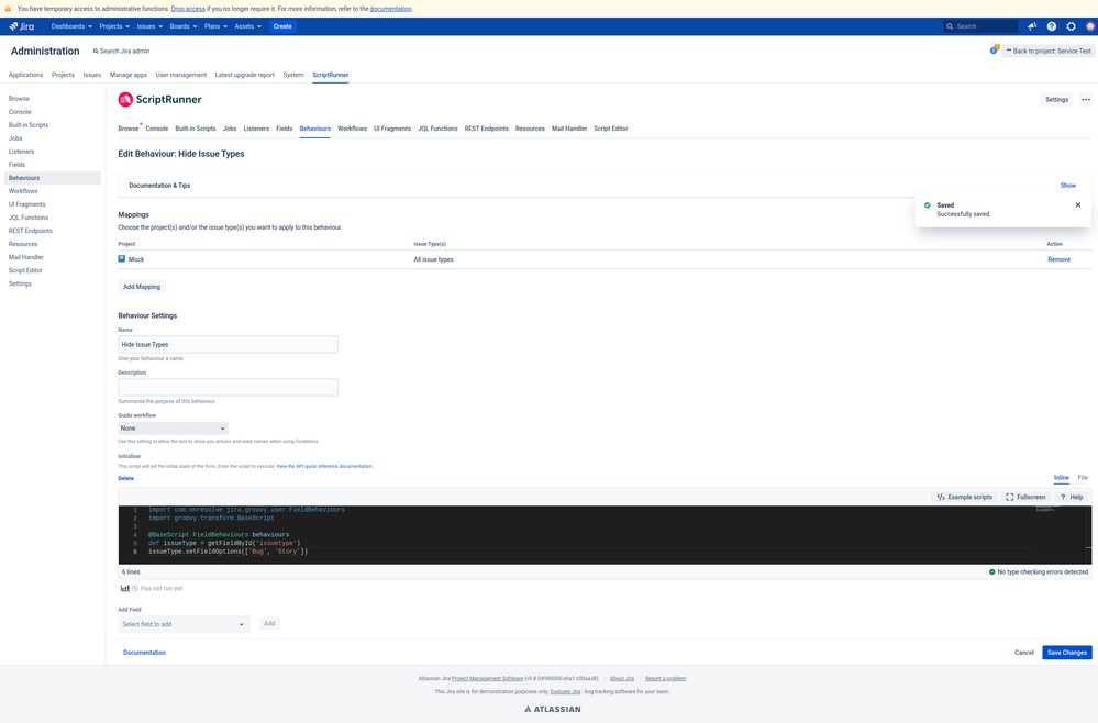

Below is a screenshot of the Behaviour configuration:-

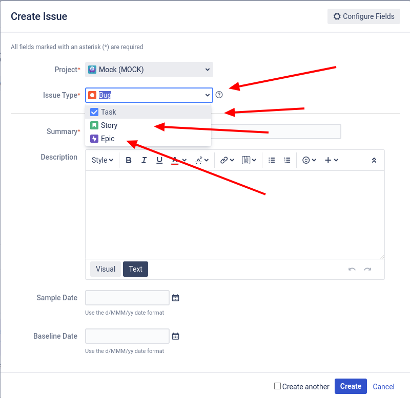

As shown in the screenshot above, the Behaviour configuration is mapped to the project MOCK. So if I try to create an issue in the Mock Project, as expected, I am only able to get 2 options from the Issue Type field as shown in the screenshot below:-
With the test above, I have logged in with my own account as the Jira Administrator.
It works the same even if I test it as a non Jira Admin user.
If the Behaviour is disabled, all the Issue Types are displayed as expected as shown in the screenshot below:-
