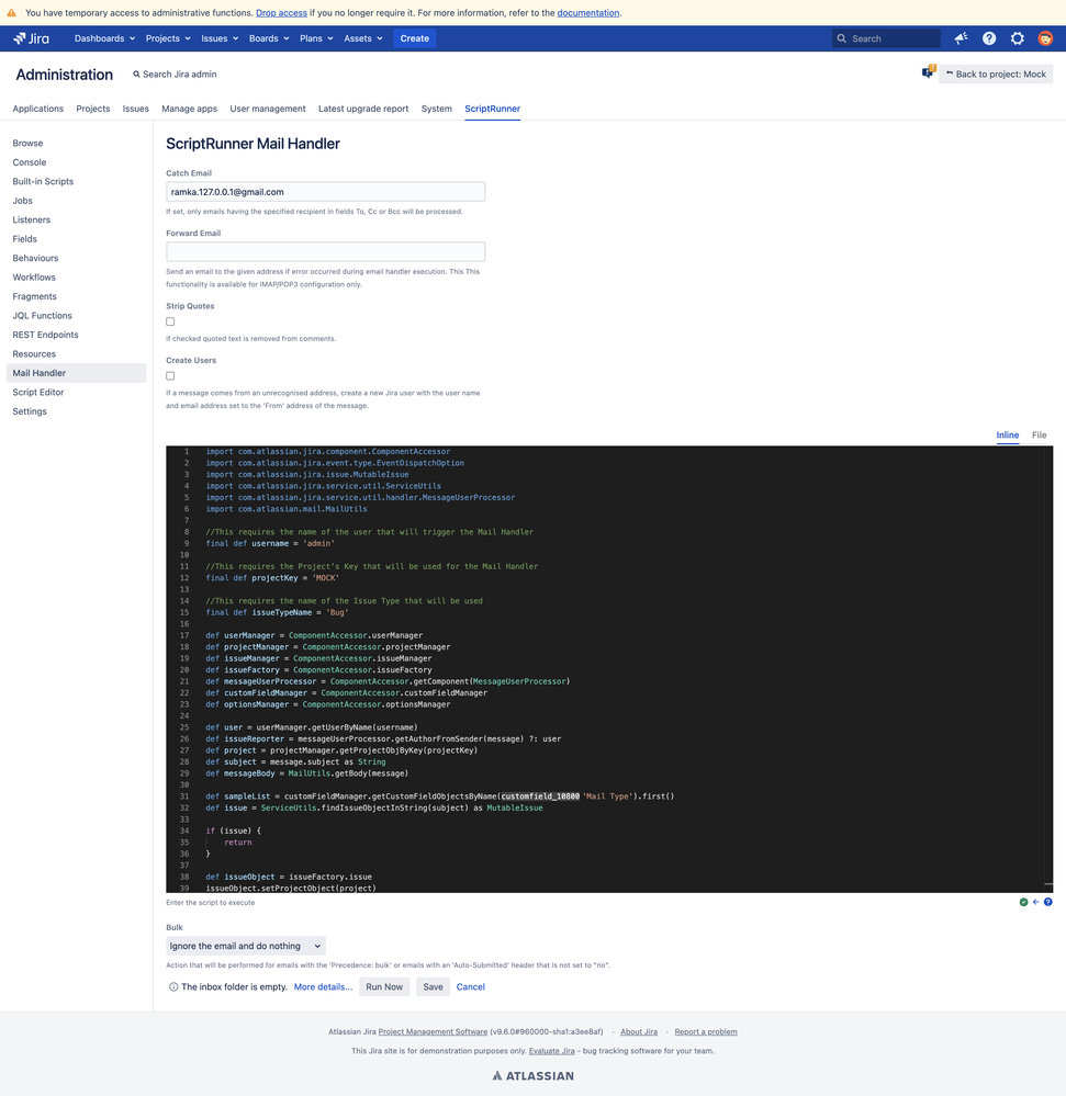

Below is a screenshot of the Mail Handler configuration for your reference:-

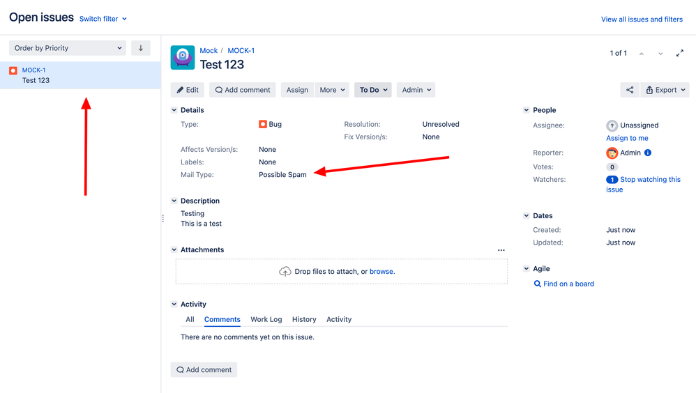

I am also including a screenshot from a test performed.
The screenshot below displays a issue that has been created by the mail handler. If you observe, the value for the custom field Mail Type which is a Single Select List is set to Possible Spam as expected via the Mail Handler.
I hope this helps to solve your question. :-)

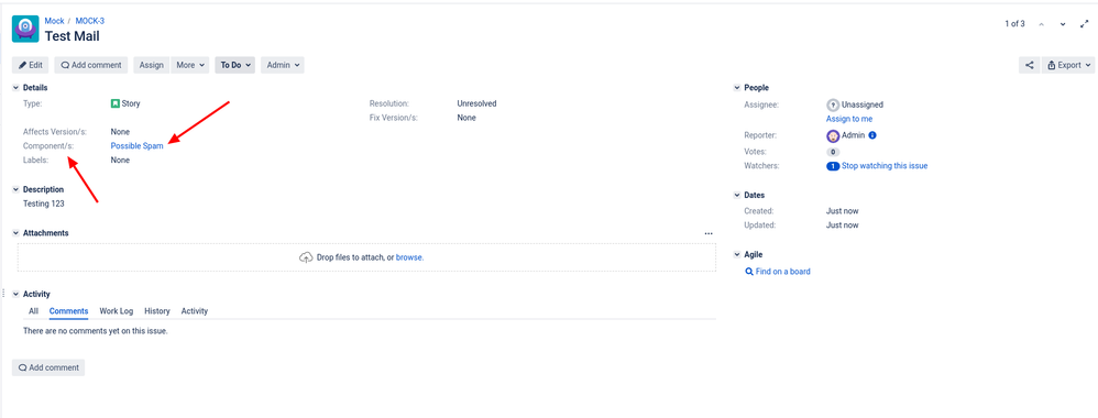

Is it possible to have a component instead of a custom field? I mean if I use a component field instead of a custom field, will it be included when an issue is created using the mail handler?
Hi @Shah Baloch
In your last comment, you mentioned:-
To answer your question, yes, it is possible, but you must modify your code.
Below is an updated working sample code for your reference:-
import com.atlassian.jira.event.type.EventDispatchOption
import com.atlassian.jira.issue.MutableIssue
import com.atlassian.jira.service.util.ServiceUtils
import com.atlassian.jira.service.util.handler.MessageUserProcessor
import com.atlassian.mail.MailUtils
//This requires the name of the user that will trigger the Mail Handler
final def username = 'admin'
//This requires the Project's Key that will be used for the Mail Handler
final def projectKey = 'MOCK'
//This requires the name of the Issue Type that will be used
final def issueTypeName = 'Story'
def userManager = ComponentAccessor.userManager
def projectManager = ComponentAccessor.projectManager
def issueManager = ComponentAccessor.issueManager
def issueFactory = ComponentAccessor.issueFactory
def messageUserProcessor = ComponentAccessor.getComponent(MessageUserProcessor)
def projectComponentManager = ComponentAccessor.projectComponentManager
def user = userManager.getUserByName(username)
def issueReporter = messageUserProcessor.getAuthorFromSender(message) ?: user
def project = projectManager.getProjectObjByKey(projectKey)
def components = projectComponentManager.findByComponentNameCaseInSensitive('Possible Spam')
def subject = message.subject as String
def messageBody = MailUtils.getBody(message)
def issue = ServiceUtils.findIssueObjectInString(subject) as MutableIssue
if (issue) {
return
def issueObject = issueFactory.issue
issueObject.setProjectObject(project)
issueObject.setDescription(messageBody)
issueObject.setSummary(subject)
issueObject.setIssueTypeId(project.issueTypes.find { it.name == issueTypeName }.id)
issueObject.setReporter(issueReporter)
issueObject.setComponent(components)
messageHandlerContext.createIssue(user, issueObject) as MutableIssue
