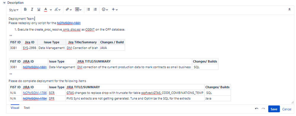

So I'm attempting to pull the description into the custom email...which is fine, I can pull a jira field without a problem using - ${issue.description}.

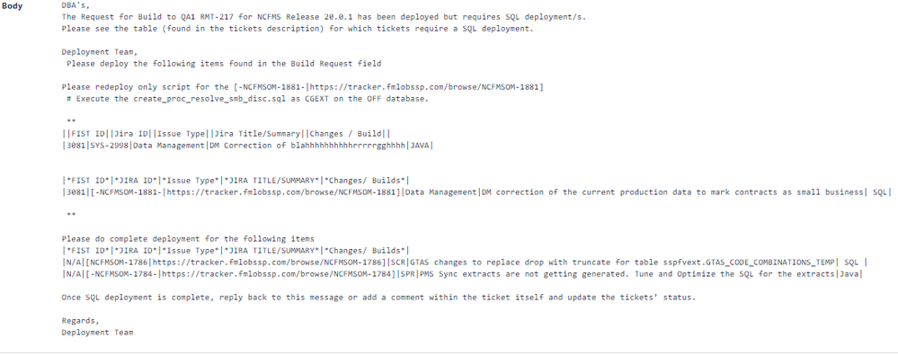

The problem is that when a table is in the description, it is imported into the email with deliminators and not the actual table formatting.
How do you get the correct table formatting into the custom email?
Here are some screen shots:
Actual issue description field with table:
JIRA Description Capture.PNG Scriptrunner Preview Custom Email: (using plain text email format)Scriptrunner Custom Email Preview Capture.PNG

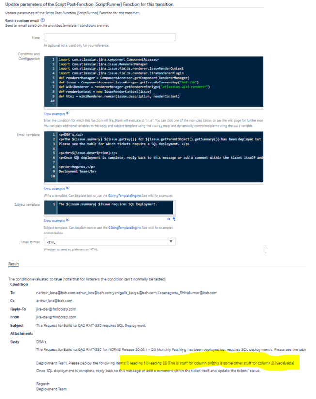

Not sure if I'm putting the code in the correct place or not since I'm not seeing a difference in the formatting...see screen shot below.
I've tried adding it in the email template itself but that doesn't work either. The description field is already set for wiki rendering, should I switch this back?
Also...I need it to dynamically pull the information so the Current Issue will be constantly changing. Will the getIssueByCurrentKey("...") dynamically change or will it look for "RMT-330" each time?

So I added only "<p><br>${helper.render(issue.description)}" in the email template field and now have columns again...see screen shot. However, I'm still not getting actual uniform table lines...

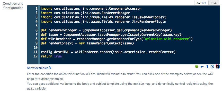

The code that Thanos provided needs to be in your "Condition and Configuration" code-block, as you have done. However, in that same code-block you'll want to take the "html" variable and add it to the "config" Map that we provide. By adding it to this Map, you'll be able to access it in the Email template.  After doing that, you'll want to modify the value that you're passing into the "getIssueByCurrentKey" method slightly. Since you want to get the description for the issue being transitioned, you need to pass that method a key for whatever issue is the target of the transition. You can do this by calling the "getKey" method on the "issue" variable that we pass in for you.
FYI: You can see everything that is provided for you by clicking the question mark with a circle around it at the bottom right of the code block. :b
Both of these changes are reflected in an example below:
On top of those two changes, you'll want to make sure that you put a condition in that code-block as well. In my case, I always want the script to run, so I just returned "true" at the very bottom of the script. But you can see more examples for writing a description in our documentation.

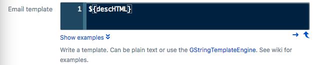

Then, once you've made those changes to your code, you'll have access to the "descHTML" variable in the Email template, as shown below:
That should do what you're wanting it to. Try it out and let me know how it goes! :)
