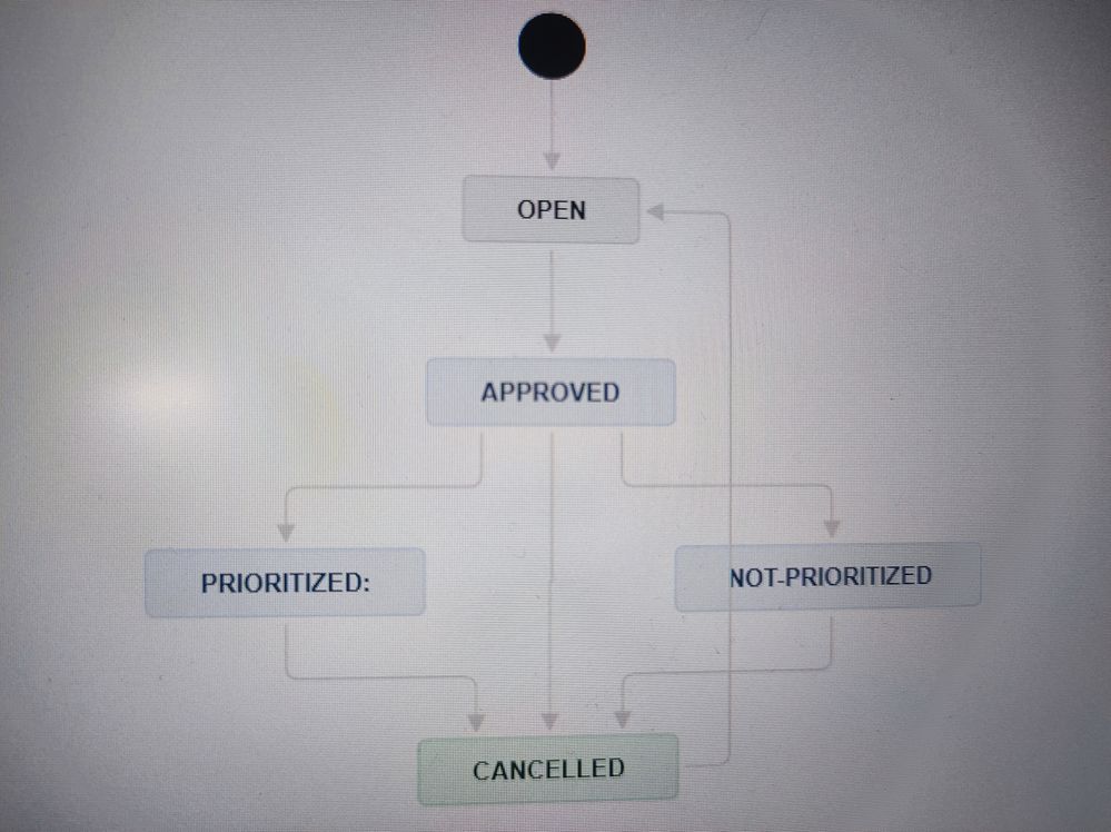

My use-case is:
A Parent issue transitions from Open status to three different Statuses (Prioritized, Not-Prioritized, or Cancelled) based on it's Child Issues' statuses.
Per my configuration:
  • Parent issue (issuetype = Initiative) is present in Parent Project
  • Parent issue has three Children (issuetype = Portfolio Epic), present in three different Child Projects
  • All Children are linked to Parent via Parent Link, present on child screen.
  • Parent should transition to next status based on Children statuses as below:
    • If all Children are transitioned to Cancelled status then Parent moves to Cancelled
    • If all Children are transitioned to Prioritized, then Parent moves to Prioritized
    • If all Children are transitioned to different statuses, then Parent moves to Not-Prioritized

Digvijay Singh Gehlot
May 22, 2025
I have the same workflow in Parent Project (Initiative) and multiple Child Projects (Portfolio Epic) as below:

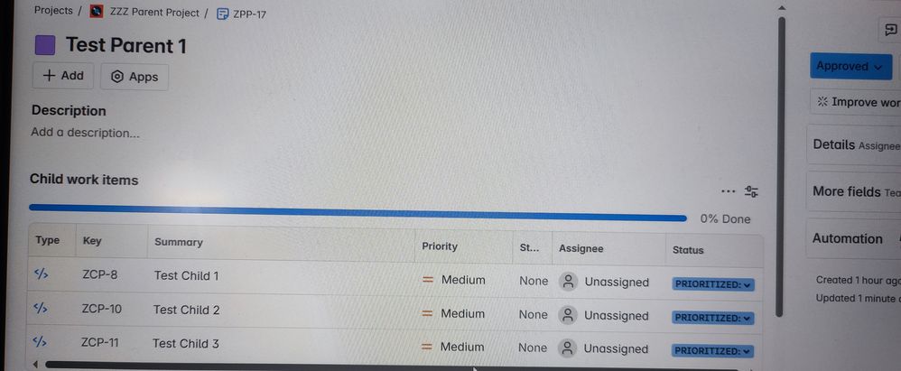

May 22, 2025
Hi @Paweł Mazur
I tested one simple scenario where if all the children have moved to Prioritized, then only Parent should move to Prioritized by using this code on Move to Prioritized transition on Child Workflow:
{% set initiative = issue | initiative("key") %}
{% if initiative %}
    {% set children = initiative | membersOfInitiative("status") %}
    {% set allPrioritized = true %}
    {% for child in children %}
        {% if child.fields.status.name != "Prioritized:" %}
            {% set allPrioritized = false %}
        {% endif %}
    {% endfor %}
    {{ allPrioritized }}
{% else %}
    false
{% endif %}
But Parent status didn't change when all the children have been moved to Prioritized
Execution log is showing:
  • Message type: workflow-error
  • Message: Conditional Execution script does not look like a valid Nunjucks condition. Skipping execution.
Please guide further, and looking forward to hearing from you soon.
