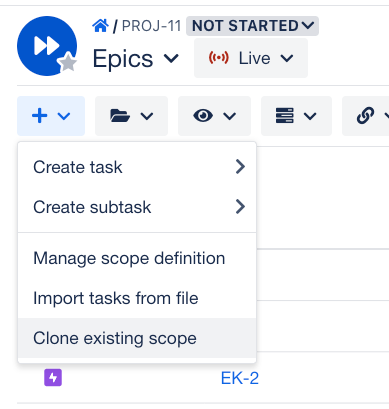

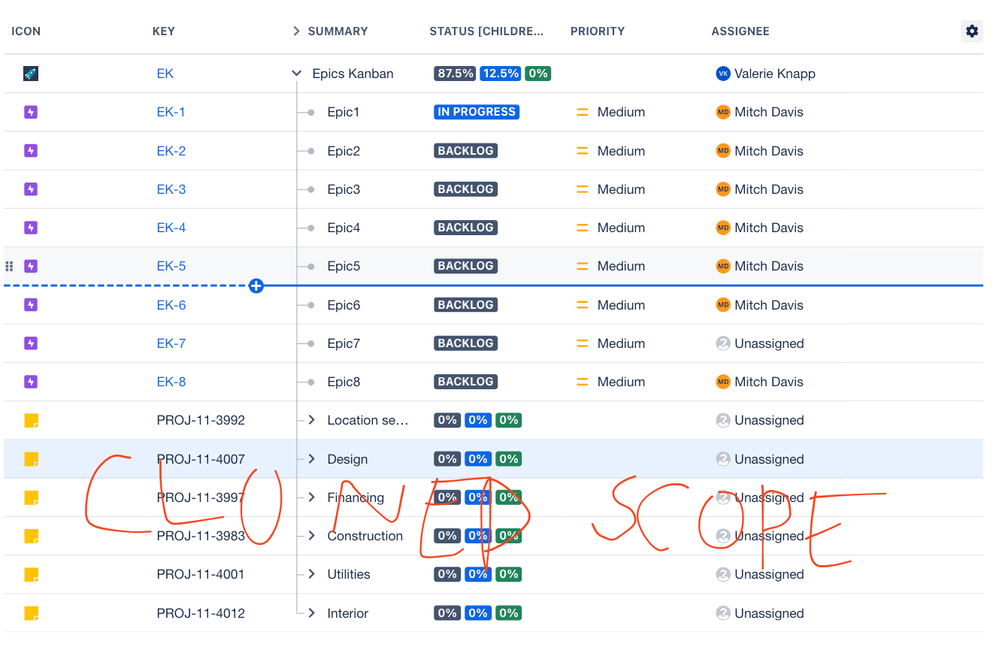

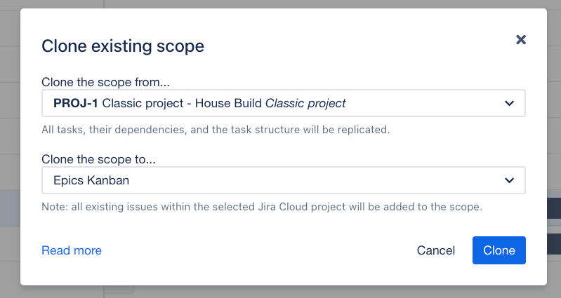

I know in BigPicture, for example, you can clone he scope of another project, like this from within the Gantt module of a box -
But this would required you to have the BigPicture app. You could install it and try it out if you want. https://marketplace.atlassian.com/apps/1212259/bigpicture-project-management-ppm?hosting=cloud&tab=overview
Cheers

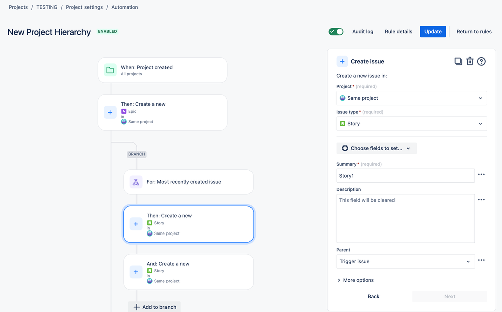

In terms of implementing a standard structure, or starting point for projects, in terms of issues and hierarchy, you could use a global automation for this.
For example, I just tested this and it works

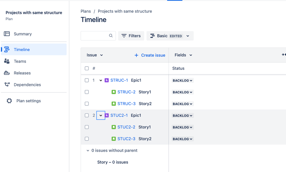

Then, in Plans, you can add the projects which have the same issue structure from the automation to get a view like this -
Is this what you wanted? Does it help you at all?

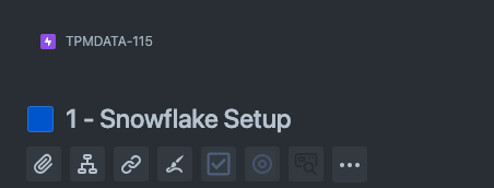

To be honest, what I'm trying is different from what you just mentioned, I have the structures view already with the epics and tasks, stories, etc I need, and what I want to achieve is that other people in my organisation would be able to "copy & paste" it to their structures with the condition that the Jira ID will change to their Project's :
In my case, every issue has the ID of my project (TPMDATA-XXX) and I'd need they change it to something like DATAPLATFORM-XXX or BI-XXX.
Is this possible? because if I can't achieve it, means that everyone needs to create their issues manually following the structure I've created ;)
