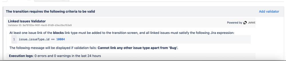

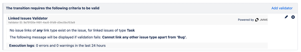

Examples that I have tried
Forbid certain linked issues
Check linked issues
Require the creation of issue links on the transition screen
None are working
It either still allows to create what I don't want/ or block everything (in the second example)
