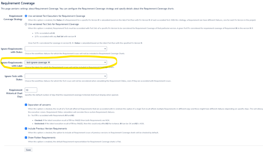

I had this checked by our jira administrator again and there is indeed a screen "Requirement Coverage" in the global xray settings where this can be done!
Have a look at the screenshot - we have configured a label called "test-ignore-coverage".
Putting this label to an issue that is of the "coverable" type, this leads to
  1. not displaying the coverage status field anymore for this issue
  2. not counting this issue for default coverage reports etc.

Would you mind directing us to that screen? I can't seem to find it, at least in Cloud 😣

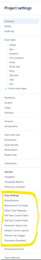

Please have a look at the screenshot - this is coming from the project settings. There is no "Coverage Settings" entry - only "Requirement Coverage", but this does not contain the options to configure labels to be ignored etc.
Hope that helps?

I'm sorry, there was a confusion from my side. The "Requirements Coverage" menu is available but "label exclusion" is not available in the Cloud either.
I've talked to my senior coleague at knowmad mood who has been working in Xray for years and he was surprised to read that documentation existed.
Excluding by label hasn't been supported for as long as he has worked with Xray, so i'm afraid the only real way of implementing your requirement is using a different issue type.
I'm sorry for the confusion!
