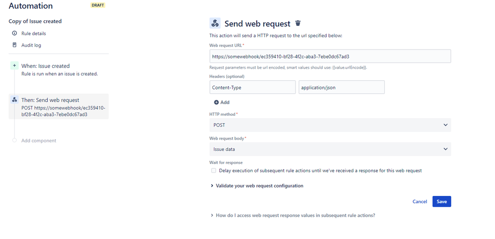

From Jira1 we send post requests to Jira2 when an issue is created using the Automation for Jira plugin. The screenshot of the rule:

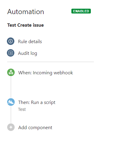

Jira2 receives it using another automation rule. Screenshot below:
