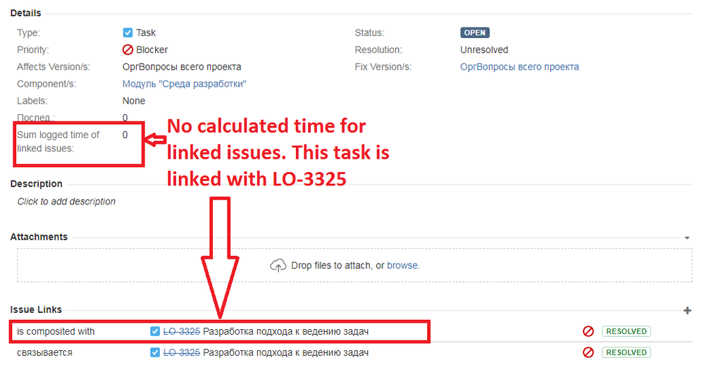

Hello, Guys!
I want to create two custom fields:
  • the sum of estimated time of all linked issues to this task.
  • the sum of logged time of all linked issues to this task.
For the above two purposes I use the following link:
https://scriptrunner.adaptavist.com/latest/jira/recipes/scriptfields/workRemainingInLinkedIssues.html
However, the time is not calculated.

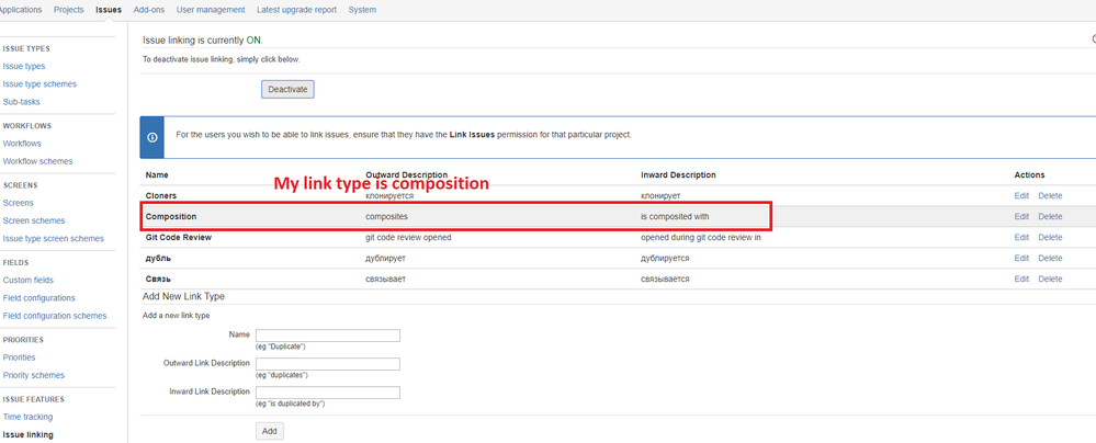

My link name is "Composition"(I've attached an image "Link type - composition") like in the example:
However, there is no calculated time(attached image of field "").
Could you clarify what I am doing wrong?
We want to buy ScriptRunner, but we would like to learn how to use it before we buy it.
Thanks in advance!
In addition, I've attached my code.
Link type is:
No calculated time in field "Sum logged time of linked issues":No time for calculated fields.png

Nic Brough -Adaptavist-
May 31, 2018
There's some things in your script that are a bit suspect, but they should all be picked up by the basic script editor built into ScriptRunner.
Could you go back to your script for the scripted field and look at the editor.  Are there any red crosses next to any lines?
Then look below it, for a box labelled "preview issue" - put your master issue in there and click the preview button.  You should see the calculated value appear, but there is also a "logs" tab there, and that's worth a look.
You can also embed log.debug ("something") lines into the script here to find out what it is doing and getting back from the issues.  Inside the "issueLink ->" loop, I would try "log.debug(issueLink.issueLinkType.name + "//" + issueLink.getDestinationIssue.getKey() )" for example, to see what links it is reading and what the types are.  Then another one inside the "if" to see if it gets there.  And so-on
zaharovvv_suek_ru
June 1, 2018
Nic, thanks for your reply. However, I've not found where Script Editor is located.
Do you mean Intellij IDEA by Script Editor?
