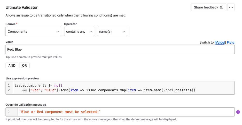

Maciej Dudziak _Forgappify_
July 28, 2025
Hi @Rees, Ian
To answer your question, let me introduce the Ultimate Validator — a feature we developed as part of the Workflow Building Blocks for Jira app. It was designed to simplify working with Jira Expressions.
The built-in Jira Expression Preview helps you understand how each expression is constructed.
Since you're already using an app that supports Jira Expression-based validators, you can simply copy the generated expression and use it in the tool of your choice.
Here is how it looks:
I hope it will help,
Cheers
