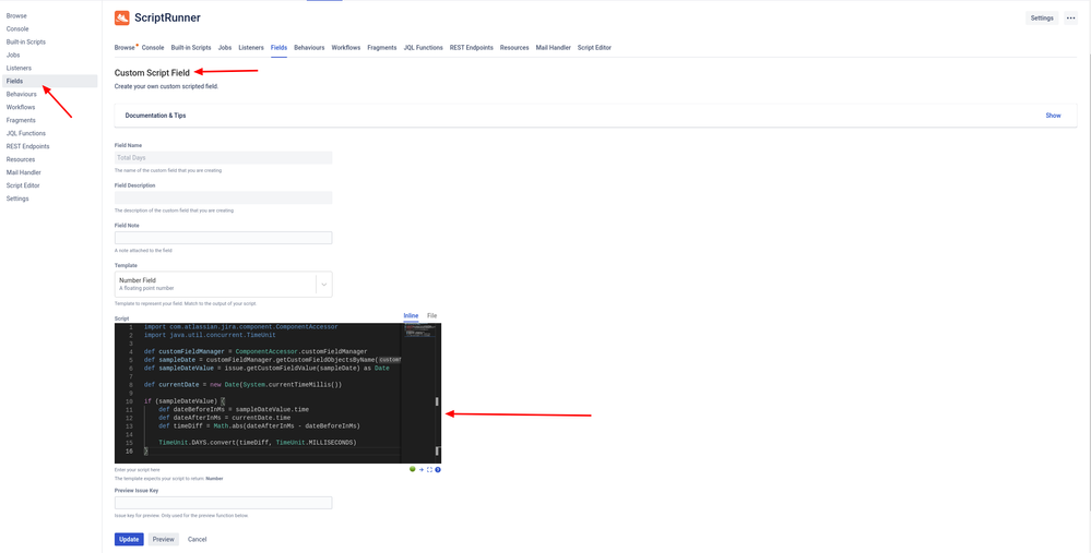

Below is a screenshot of the Scripted Field configuration:-
As shown in the screenshot above, the Scripted Field type used is the Number Field.

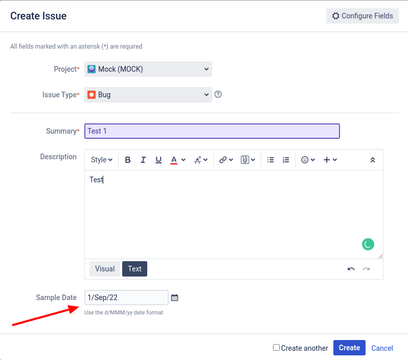

Also, I include a few test screenshots for your reference:-
1. First, I create a new issue and set a date for the Sample Date field. For this example, the date field has been set to 1st September 2022.

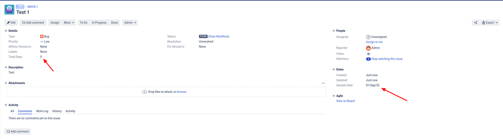

2. Once the ticket is created, as expected, the Scripted Field calculates the difference between the date set in the Sample Date field to the Current date (10th September 2022).
As expected, the result displayed in the Scripted Field is 9.

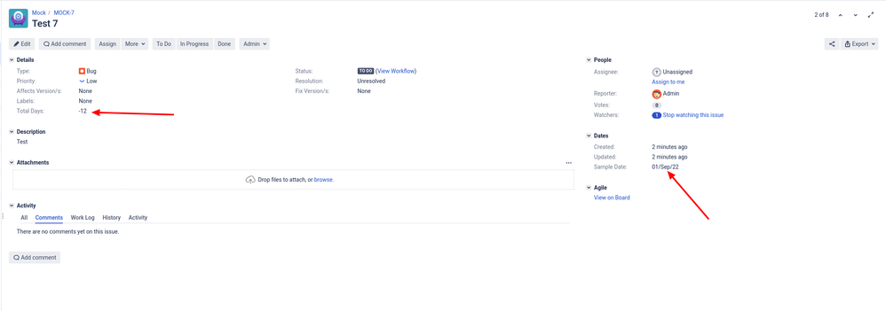

1. If the Date in the date field has been set for a later date, the result will be a positive number, as shown below:-
2. And if the date in the date field has been set for an earlier date, the result will be a negative number, as shown below:-
