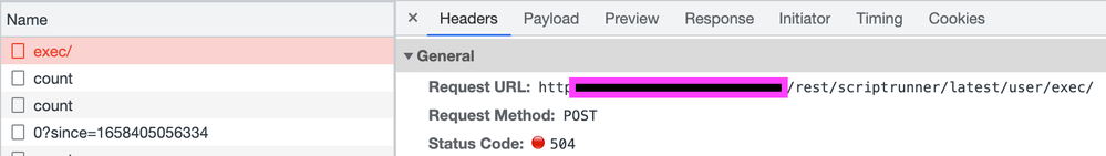

I can reproduce it over and over again. I'm trying to narrow it down to a minimal set of code that I can provide to Adaptavist. My script is calling Confluence REST APIs from the Console, on Confluence Data Center.
Chrome Browser tools suggest that the server returns a 504 when I get the 'Failed to post update' error. This must be called by Adaptavist when you press the RUN button.
The payload to this call contains my console script.

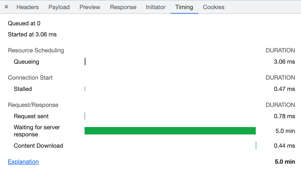

It could very well be due to a script taking more than 5 minutes to run...this is just what I'm seeing:
