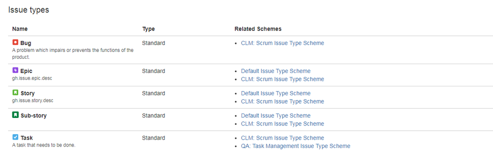

I want to calculate the sum of the values of a custom field (Technical Points) belonging to issuetype – Sub-story. Further, I want that value to be placed in another custom field (Aggregate Technical Points) belonging to a custom issuetype - story. Attached screenshots display different
Attached screenshots display different issuetypes (Story and Sub-story) that we are using, just to avoid confusions.

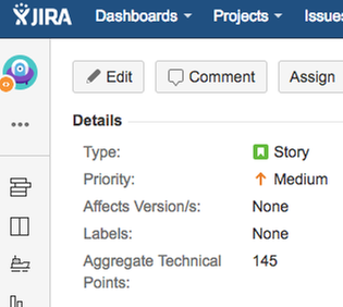

Hi Swapnil,

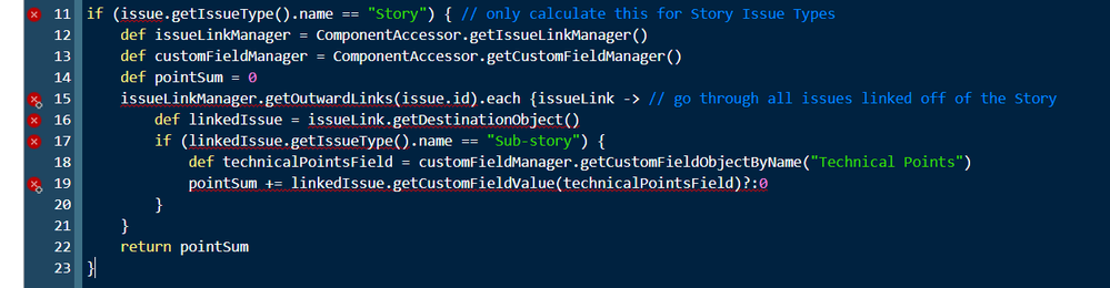

I created the following script to be used in a scripted field. It gets all of the links from the Story and checks to see if the are of type "Sub-story". If there are "Sub-story" linked issues, it will get the custom field value from "Technical Points" on each issue. It will return the sum of all of the Sub-story issues linked to the Story.

Image of it working:
You should also make sure that the Template for the Scripted Field is set to "Number Field" and that the Searcher is set to "Number Searcher".
Hi Joshua,
The query is giving me the error.
It says "The variable issue is not declared"

Hi Swapnill.
That is an inline error, not a compilation error. The script could be working at compilation time. Could you save the script regardless and try to see if the script works?
