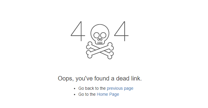

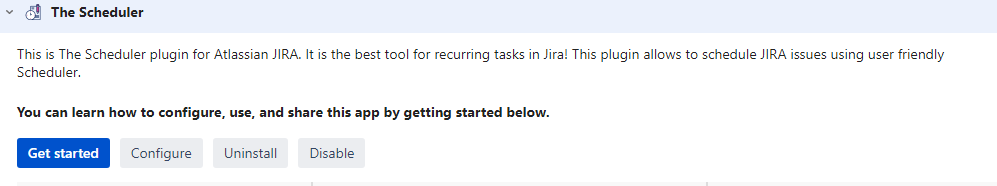

I installed the plugin both ways. After a long time, the plugin installed, but I encountered a 404 error in the configure section of the plugin. I have uploaded photos of the error as well. Can anyone help me with this issue?
