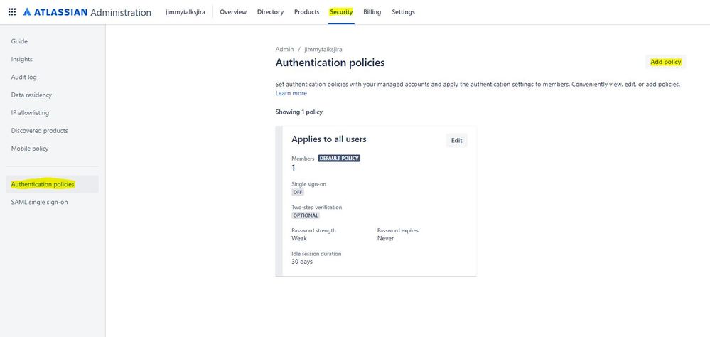

  1. you will need to get to the Atlassian Organization Admin page, which you can do by navigating to https://admin.atlassian.com, then selecting the Organization you wish to manage.
  2. Next, you will want to navigate to the Security → Authentication policies menu options
  3. If you don’t already have a security policy with “two-step verification“ set to Required, click Add Policy (otherwise skip to #5 )
  4. In the popup, enter a name for the policy (use something that will make sense later like “Enforce 2FA“), then click the “Add“ button.
  5. In the policy screen make sure to change the “require two-step verification“ radio button to “Required“. The, click the “Update“ button.

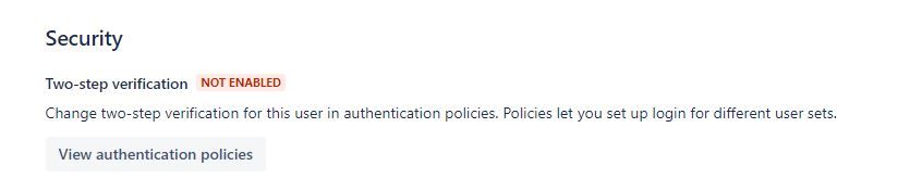

  11. Click on the “Show details“ link for a user that was added to the new policy, you should see a green, “Enabled“ next to the “Two-step verification” Security setting.
  3. If you want to create a new security policy instead of using the default “Applies to all users“ policy follow the “Add policy“ steps from the Enabling Two Factor Authentication steps. Otherwise, continue to follow along.
  4. Edit the default “Applies to all users“ policy (this assumes you have not altered this policy from it’s default state with “Two-step verification“ set to Optional).

  13. Click on the “Show details“ link for a user that was added to the new policy, you should see a red, “Not Enabled“ next to the “Two-step verification” Security setting.
