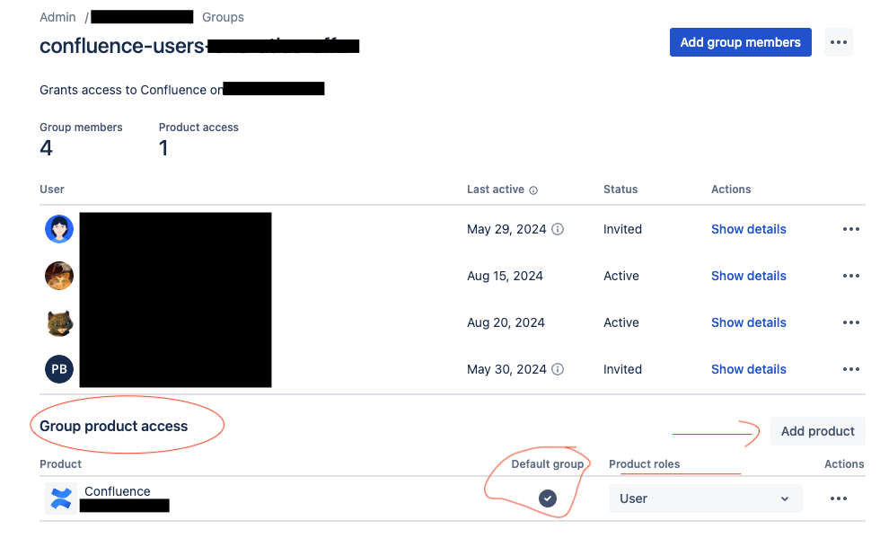

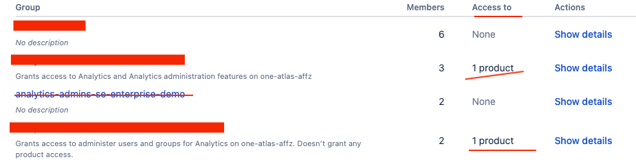

* Have those users logged into the new system yet? It may be they just need to log on to complete the connection.
* Are you using Atlassian Guard? They could be in the wrong authorization group. I don't know that much about Guard, but if you are using it, just reply here and someone with more experience will help you.
* Are they in a user group that includes access to the system? In Cloud there are specific groups that grant baseline access to the site. Check the groups and make sure those people are included in one of the groups that have access.
If you click on "Show details"  for a Group, you get this screen. At the bottom is tells you if a group also grants product access and if it is the default group for product access. The default role is generally "User".
Group details.png If the group you are using for basic access does not have a product associated with it, you can add one by clicking "Add Product" and following the prompts.
