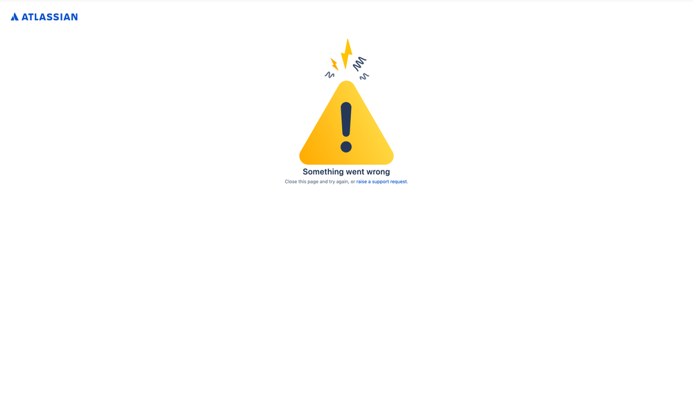

Dylan Di Filippo
June 17, 2025
I have this issue when I try to connect to the integration and I accept the connection
