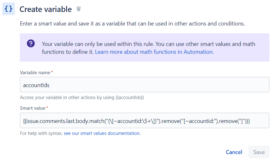

Hi @Bill Sheboy, thank you for your answer!
I re-read the documentation yesterday and found that the match() function actually returns not the first occurrence, but all occurrences as a collection (if there are more than one occurrences), so it works. There is a nuance - you still have to use the split() function in advanced branching (probably a bug), but, in the end, everything is ok.
Here's what it looks like:
Or you can just try to use the following smart value in the advanced branching smart value field:
{{issue.comments.last.body.match("(\[~accountid:\S+\])").remove("[~accountid:").remove("]").split(",")}}
And now you can perform a separate action for each {{accountId}}.

Alex F
September 22, 2022
@Bill Sheboy thank you for the hack, I tried to drag-n-drop if/else branch, but it can't be dragged 🤷‍♂️ All other elements move easily.
If it was a collection, we should be able to immediately iterate over it.
You're right, so I checked it carefully again and found that when you create an intermediate variable the collection is converted to text, so the best way to achieve the goal is to use match() function directly in advanced branching block (it just didn't work for me the first time, but now everything is ok):
So you can just use the following expression in the advanced branching block and then you can do whatever you want with each {{accountId}}:
{{issue.comments.last.body.match("(\[~accountid:\S+\])").remove("[~accountid:").remove("]")}}
