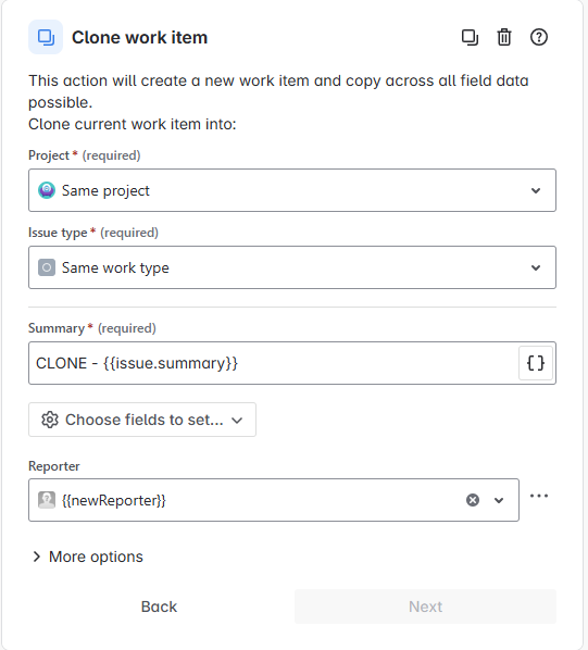

The simple solution is to set the initiator as the reporter on the cloned work item. If you want to do this, when you Clone the work item, set the Reporter in the Clone ticket to {{initiator.accountId}}.

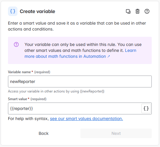

In the case of my client, this solution works. However, in many cases, you really do want the original Reporter to be carried over to the cloned work item. In that case, you need a few steps to manage this potential problem. Following is a step-by-step guide to addressing this problem.

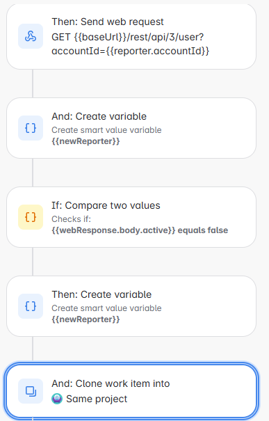

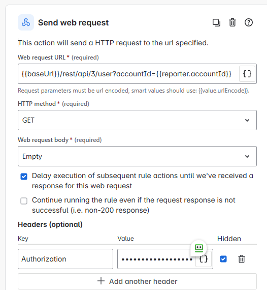

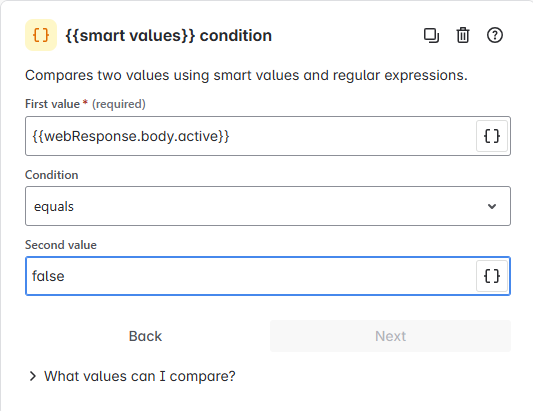

The first step is to determine whether the Reporter is active or inactive. This Webhook call will respond the needed information.
You will need to create the Authorization information. To do that, see this page.
