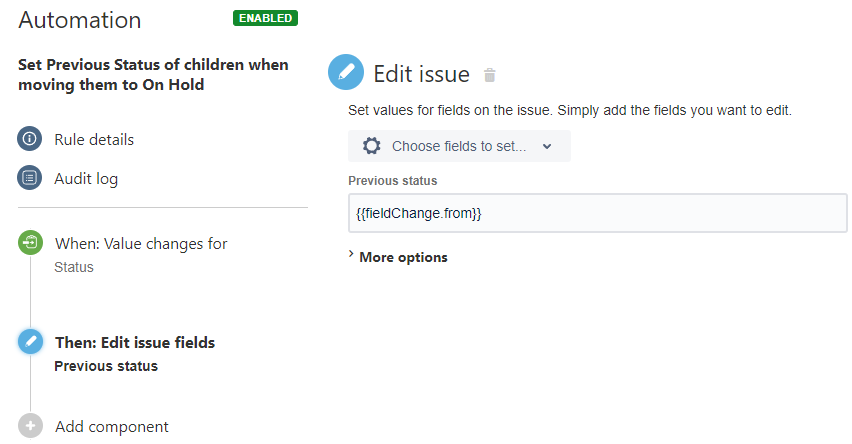

Obviously, you need to have the status of each issue before it was put to “On Hold” stored somewhere. Here comes Jira Automation handy again with the following simple rule:
Here you trigger the rule when the status of issue changes and using the smart value {{fieldChange.from}} simply store the name of the previous status in a text custom field, called “Previous status” (make sure you have such field and it is applicable for all your issues under the Project).

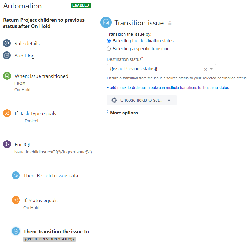

Now that you have your issues in status “On Hold” and in each issue you have stored the previous status, it is easy to use Jira Automation again to resume your project by using the following simple rule:
Here you trigger the rule when your project is moved from “On Hold” status to where it was. Then you branch using the same JQL to get all the children issues of the Project and if their status is “On Hold” – you transition them to the Previous status, that was stored before. And suddenly your Project comes back to life where it stopped, all your teams see their tasks active again and can resume their work.
