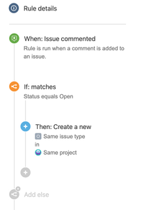

Cool. And to clarify, you have to use If/else blocks, not If: blocks right?
My experience has been that if an If: block fails, the rule stops then and there.
So then, this:
Not this:

Rodrigo Martinez
May 3, 2021
Hi @Darryl Lee
Indeed! I just edited both the article and the KB! 🙇‍♂️
Here's a visual on how it'd work:
Cheers!

Actually, that's how Automation works: it fully matches JQLs and treat results in batch on every condition!
Mind, though: ACTIONS are performed in each issue (in bulk or individually), but CONDITIONS are nothing but JQLs disguised in a fancy look & feel, let's say.
There's a "JQL condition", but that's like the "advanced search" in Jira: it just allows you to get more creative into the query.
The TRIGGER/WHEN is always a JQL. On most cases it's just [key = JIRA-123], but on the scheduled trigger you can add your own JQL.
Then CONDITIONS only keep executing searches appending AND clauses to the initial search. The condition evaluates to TRUE if the search returns anything, and FALSE if it's empty.
The example below runs 2 JQL searches (supposing the comment as added to JIRA-123):
On WHEN: [key = JIRA-123]
On IF: [key = JIRA-123 AND status = Open]
I was 🤯 when I realized Automation Conditions are just JQL searches!
(This is also the reason why the rule fails if you delete an issue then perform any condition after it, but that's a topic for another article! 😅)
