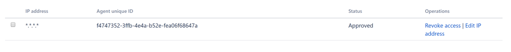

What I think happens though is that up restart, your agent connects from a different IP. When agent is first connected, the UUID is matched to _exact_ IP chain (IP of the agent host + IPs of the proxy servers in between). When you start a new container in Kube, it is likely to be assigned a different IP.
Here's what you do: you go to Agents -> Agents Authentication, find the UUID and manually edit the IP filter so that it matches all possible IPs your agent can connect from.
I see I have experimented with that as far as I can remember, but I will give it another run.
What I have now is the following:
*.*.*.* {UUID} Approved

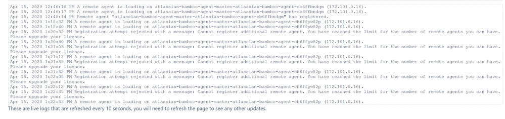

Logs:
Apr 15, 2020 12:46:10 PM A remote agent is loading on atlassian-bamboo-agent-master-atlassian-bamboo-agent-cb6ffbndqm (172.101.0.16).
Apr 15, 2020 12:46:17 PM A remote agent is loading on atlassian-bamboo-agent-master-atlassian-bamboo-agent-cb6ffbndqm (172.101.0.16).
Apr 15, 2020 12:48:14 PM Remote agent "atlassian-bamboo-agent-master-atlassian-bamboo-agent-cb6ffbndqm" has registered.
I will report back once we restart the container.

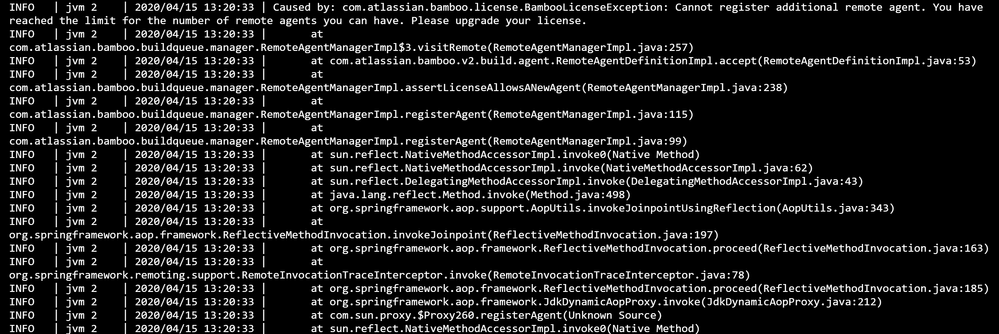

Now deleted the Pod, and upon restart & boot, the following error is printed on Agent Pod:
There is no new remote agent trying to register.
It is not allowed to register. I bet that the IP matching works. There seems to be something else to Agent's unique ID.
The agent then goes into a JVM exit-restart cycle:
ERROR | wrapper | 2020/04/15 13:27:14 | JVM exited unexpectedly.STATUS | wrapper | 2020/04/15 13:27:19 | JVM process is gone.STATUS | wrapper | 2020/04/15 13:27:19 | Launching a JVM...INFO | jvm 16 | 2020/04/15 13:27:19 | WrapperManager: Initializing...
After a few crash-restart cycles, the Agent is allowed to register. It seems that Bamboo is not using strictly the UUID, but also the agent's name. The previous one has to be TTLd by Bamboo and the new one not exactly detected as the same Agent.
| Apr 15, 2020 1:28:54 PM A remote agent is loading on atlassian-bamboo-agent-master-atlassian-bamboo-agent-cb6ffpw82p (172.101.0.16). |
| Apr 15, 2020 1:28:56 PM Remote agent 'atlassian-bamboo-agent-master-atlassian-bamboo-agent-cb6ffbndqm' was unresponsive and has gone offline. |
| Apr 15, 2020 1:29:19 PM Remote agent "atlassian-bamboo-agent-master-atlassian-bamboo-agent-cb6ffpw82p" has registered. |
