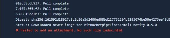

I have done everything as you write above, but somehow when Pipeline try to find an attachment - it shows an error.
Here is my ymlFile, can you please tell me - what I have write wrong so attachment doesn't loads.

UPDATE

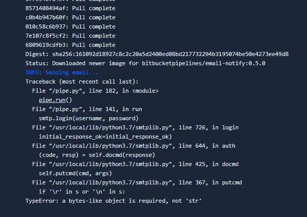

Have added full path to the file and it looks like it works. However the email is not send anyway sendingEmail.jpg
