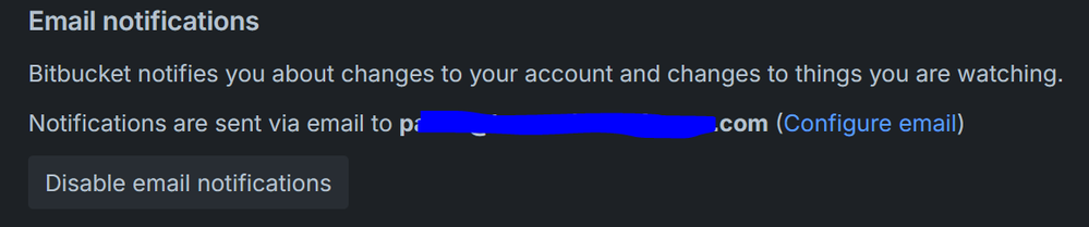

I do not see any inconsistency between requirement you highlighted and my settings, but still do not receive "commit" notification emails.
1. Email is correct (i receive invitation and other communication from bitbucket)

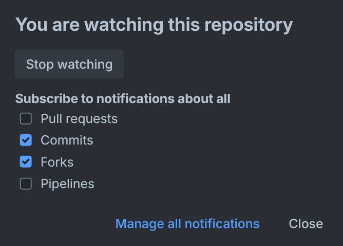

I am watching repositories I expect to receive emails from.
These are notification emails I expect:C2.PNG

Could you please check and let me know if you are receiving the Notification for the Commits performed by your colleagues on the Repository?
Also, as discussed on the feature request BCLOUD-11596, notification emails for own commits or other watched actions of a repository are not triggered to the end users.
