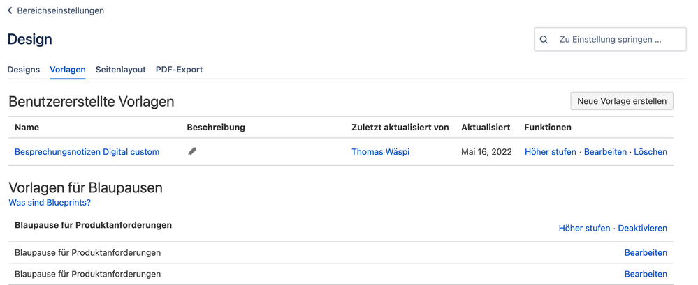

hi, small note concerning the publish pages function: at the moment, in our environment, only custom templates are recognized by the confluence automation. all global templates and adapted global templates are not seen. would be great if they are also indexed and shown to choose from the list.

@Thomas Wäspi Thank you for calling this out! To clarify - are you referring to blueprint templates vs custom templates?
Thomas Wäspi
May 16, 2022
@Sheerine Baucum sry i meant blueprint templates, we can't see them in the dropdown, see also (german) screenshots:

But we can see all the custom made:

May 16, 2022
@Thomas Wäspi The blueprint templates are not currently supported, but we are working to incorporate them in the drop-down to improve this experience. If you are using blueprint templates regularly and would like to include them in automation right now you can copy them as a custom template and they will appear in the dropdown.
Thomas Wäspi
May 17, 2022
@Sheerine Baucum thank you, that was also my workaround for the moment, that's working fine.

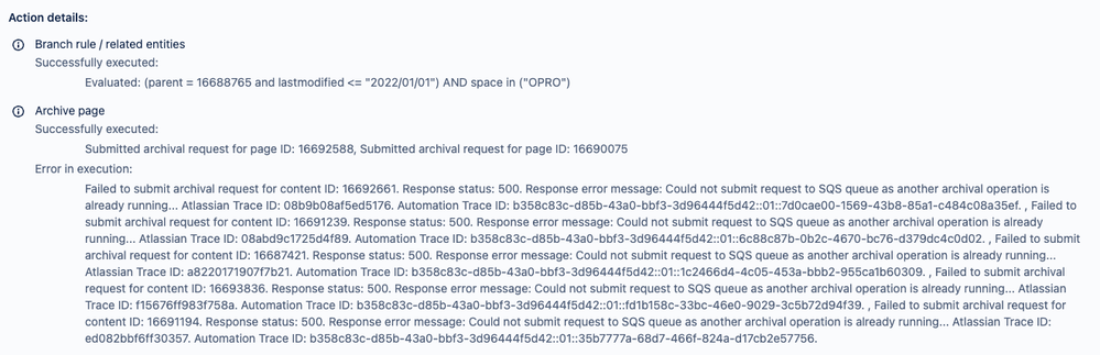

@Sheerine Baucum I tried it with the branch rule/related entities I think that worked out, but I still get an error message for that automation.

@Malin Rathjen
Regarding your error message question -
1. Did the rule run successfully eventually?
2. This error appears most commonly when running a bulk-archival rule. We currently allow one archiving operation at a time. So until the other archiving process is complete, no other archiving process can be started. This is on our roadmap to address.

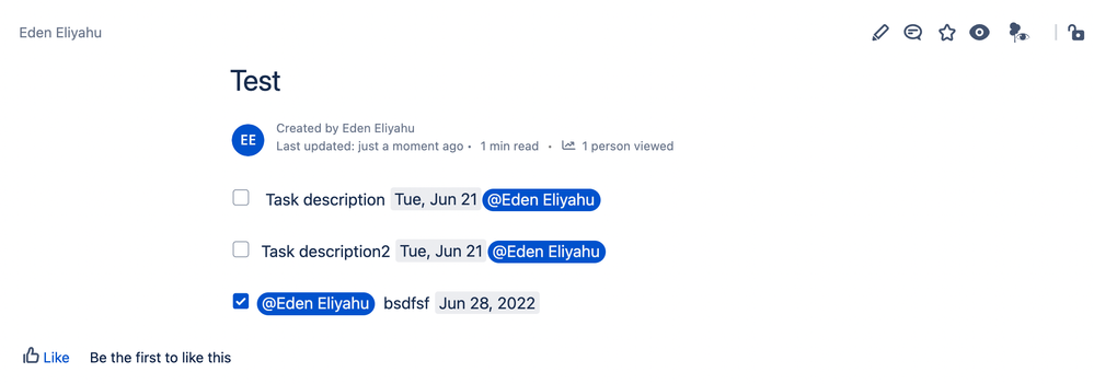

Eden Eliyahu June 8, 2022
Hi, @Sheerine Baucum
we are trying to use automation for confluence for slack notifications to incomplete tasks.
We have the smart values you have already published:
Task Related
These Smart Values are accessible in the “Branch rule / for each task”-branch rule
{{task.globalId}} - returns the global ID of the task
{{task.id}} -returns the local ID of the task
{{task.contentId}} - returns the content ID of the page
{{task.status}} - returns the status of the task (e.g. incomplete, complete)
{{task.body}} - returns the text content of the task as Confluence XML
{{task.creator}} - returns the account ID of the user that created the task
{{task.assignee}} - returns the account ID of the user that is assigned to the task
{{task.createDate}} - returns the UNIX Timestamp of the creation of the task
{{task.dueDate}} - returns the UNIX Timestamp of the due date of the task
1. The (task.body) is in XML. The task description is the most important smart value, is there any chance you have a task body smart value, not in XML?
2. As you can see in the picture I attached, the due date in UNIX and i can’t change it to regular date.
3. Also the Assignee is ID. Is there any option we can use display name?
I will appreciate your help.

Eden Eliyahu September 12, 2022
Hey @Sheerine Baucum
We were able to send slack messages regarding incomplete tasks, but there is one major problem: we couldn't send incomplete tasks for a specific page.
Message sent to Slack with all the incomplete tasks in all the space.
Do you know how to resolve this issue?
Like Alex Barnaba likes this
Sheerine Baucum
September 12, 2022
@Eden Eliyahu Just to confirm my understanding -  You want a slack message with a list of incomplete tasks by page or are you wanting to narrow the incomplete tasks by a specific page? Or something else? Thank you!
Like Eden Eliyahu likes this
Eden Eliyahu September 15, 2022
@Sheerine Baucum  Hi, to narrow the incomplete tasks by a specific page.
