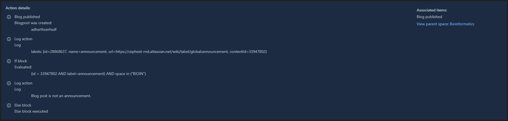

This is an entry in the audit log for a blog post which should have triggered the message but did not:
The log shows the following condition evaluated in the IF block:
(id = 33947802 AND label=announcement) AND space in ("BIOIN")
If I use this exact query to do a CQL search using the REST API I get the expected single result which is the blog post that triggered the action.

If you look at the audit log, it displays the message "Blot post is not an announcement" which comes from the log action in the "else" block. Unless I've structured the if/else wrong I think this means I'm not hitting the message action. I have also verified the Teams webhook is working independently.
