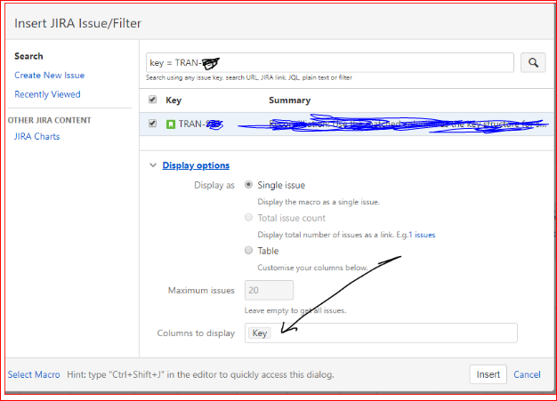

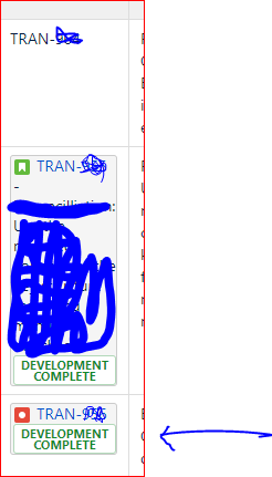

@Kuncheff My requirement was to display only the Key. I was able to select using your method. However, now I see key, summary and status in my confluence page. The 'Hide Summary' option, does not seem to kick in even if i select it. This seems really weird.
Row 2 -> using Table, select only Key, then select single issue, then hide summary
Row 3 -> using Single issue(columns to display is not editable), then hide summary. But I do not want status to show up.
Update: I was able to get rid of the Summary, by selecting summary along with key in the Columns to display, then do the Hide Summary. However, the Status still remains!
