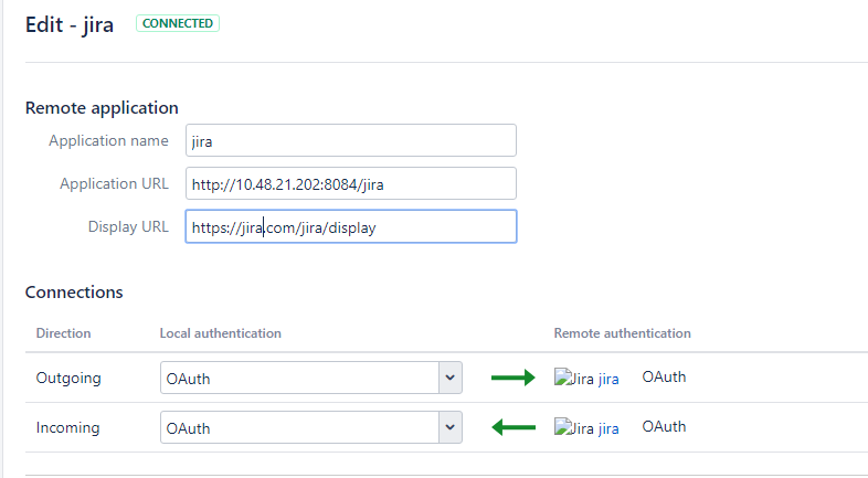

I've successful linked confluence and Jira (OAuth connection for both), however i can't create Jira issue from confluence the marco still Loading and no Jira project appear.
Both application are hosted on the same server, they listen on different ports, and they are both reverse-proxied via IIS.
The application links are set up via the added connector port numbers and the display URL is configured to show the proxied URL.
