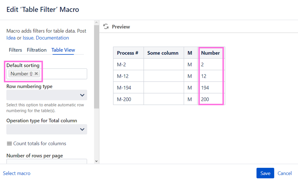

We can suggest a workaround for the first case: wrap your ConfiForm macro into the Table Transformer macro and then into the Table Filter macro.
Use the following SQL query for the Table Transformer:
SELECT *,
T1.'Process #'->split("-")->0 AS 'M',
T1.'Process #'->split("-")->1 AS 'Number'
FROM T*
It will split your "M-XX" into two columns (M and some number), so you'll be able to sort them properly later:

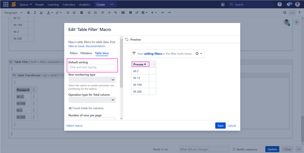

And have you tried the Table Transformer?
When I check the sorting using a manually created table and the Table Filter macro, here is my result:
After the Table Transformer macro the result is different:

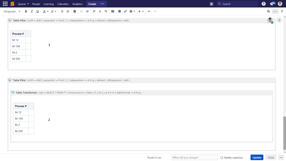

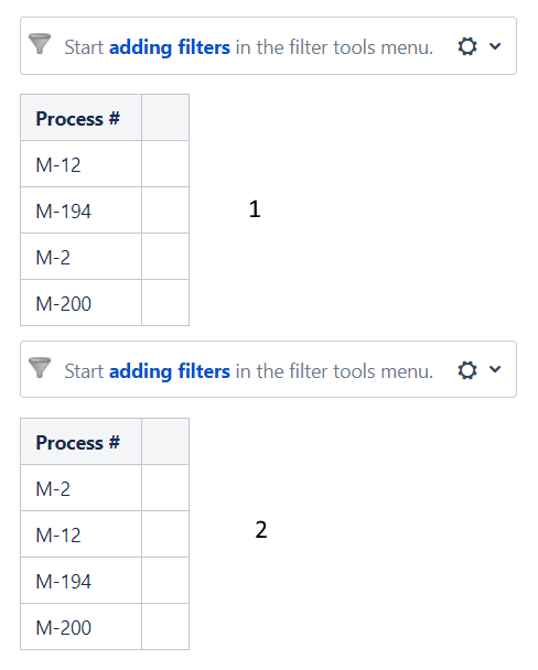

Here is how the default Confluence sorting into headers works for me:
The first variant is wrong - it's a table wrapped into the Table Filter macro (without it's own sorting).
The second variant seems to be right - it's a table wrapped into the Table Transformer macro and then into the Table Filter macro.
I don't use any specific settings for the Table Transformer - just insert the macro and put a table inside its body (I don't change the default SQL - it remains "SELECT * FROM T*").
And I don't use any sorting inside the Table Filter macro - just click the standard arrows in the table headers and it seems to be working.

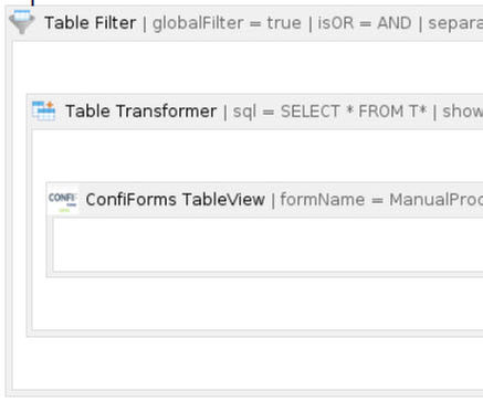

As per our discussion, this is how I have set up the table view of the ConfiForm Table data to properly sort numbers rendered in text format by ConfiForms -
But now, this does not register inline edits anymore. Everytime I make an inline edit in this view and click on the blue tick icon to save the change, it disappears on refreshing the page.
We caught this a little late as it shows in the table right after saving but the next time when we visited the page, the information had disappeared again. Lost a lot of important updates because of this. On further scrutiny I realised this is solely because of the Table Transformer macro as removing it from the middle fixes this problem. But then I'm back to square one with the sorting problem. So right now its like prioritizing which feature is more important for us - sorting data correctly or having inline edit functionality.
