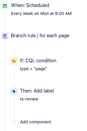

Automation 1: Add automation to automatically add label "ts-review" to content that hasn't been updated within the last 6 months.
*This is working as intended.
