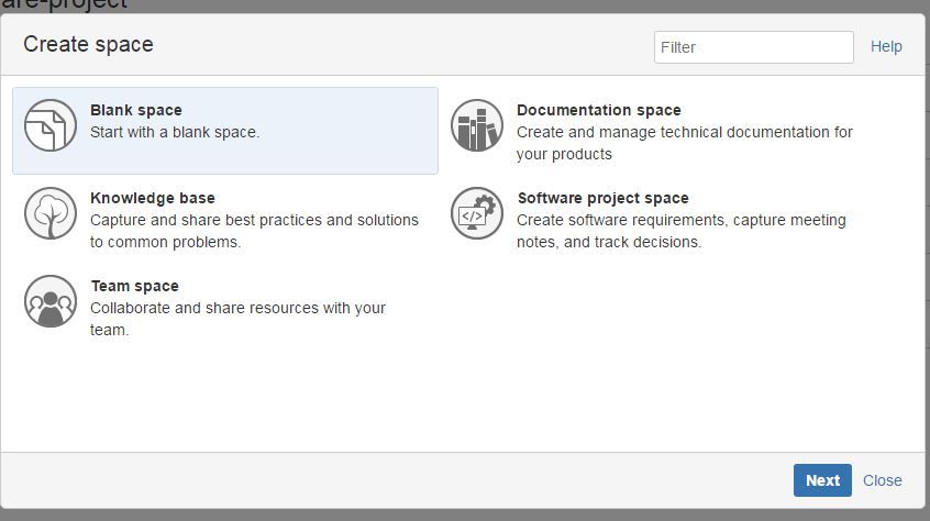

sn
August 16, 2017
hi nic,
I'm taking about the "software project" space blueprint and blank space blueprints.
Like matthew Earp likes this
Nic Brough -Adaptavist-
August 16, 2017
Blueprints pre-create a set of pages and populate some of them when you use them to create a space.  The "blank space" does nothing, so you just get the space and no pages.
The different blueprints do different things.  Rather than repeat the docs and write a dull essay that misses a lot of stuff and varies by version, I'd suggest you create four spaces, one of each type, and have an interactive look around each!
