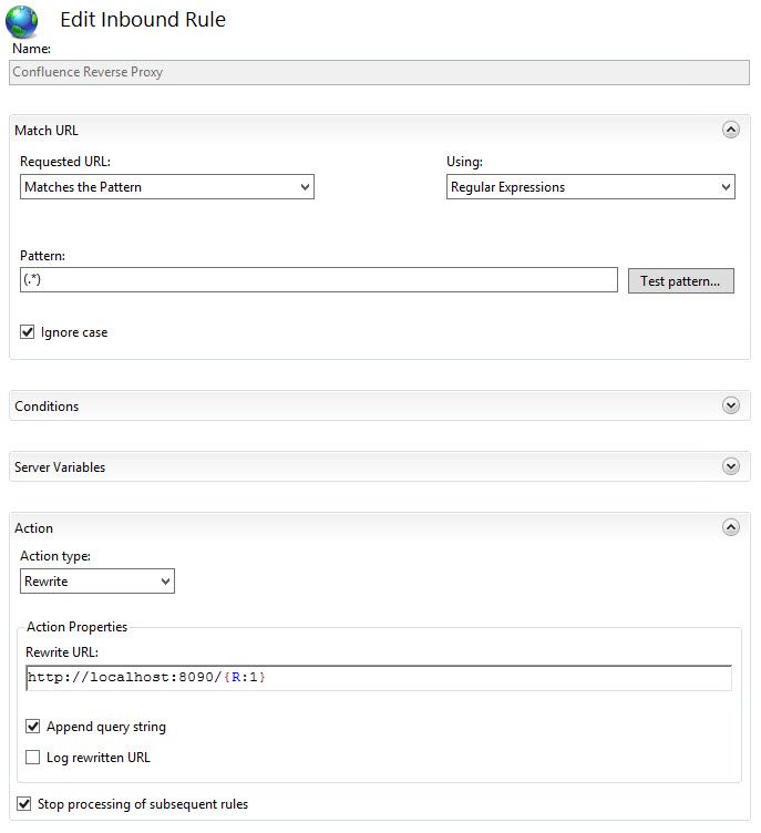

The rules above are good but the first one redirects to the wrong location.

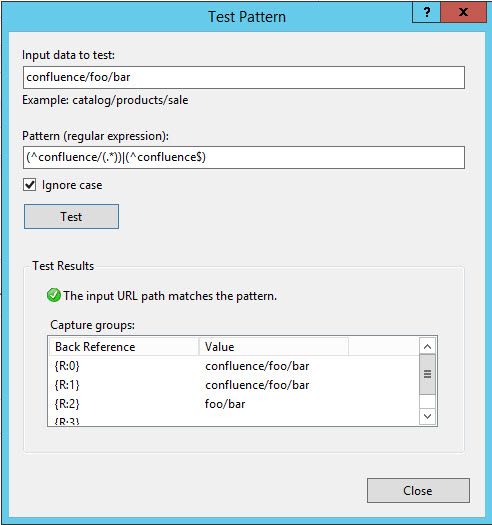

I came across this exact same issue two years later and this post helped. My URL Rewrite rules in IIS were broken. I was effectively dropping the confluence from the redirect using {R:1} with the pattern below.
(^confluence/(.*))|(^confluence$)

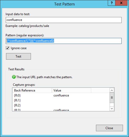

For "https://domain.com/confluence", the pattern matched but only {R:0} and {R:3} contained the path required for the rewrite. Adding a trailing back slash or using {R:0} rectified the issue so I had to revisit my rules.
If you're seeing this issue, double check the URL Rewrite rules in IIS and retest your patterns.

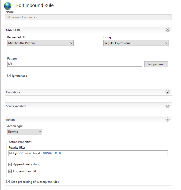

Have tried to update the URL rewrite to {R:0} but still it doesn't work.
"Adding a trailing back slash" - could you please exlain more on this? thanks.
Zhi
I'm not sure why my screenshot was dropped. This is my current rule but it uses a subdomain "https://confluence.domain.com" so I do need everything after the domain.
Just to clarify, I wasn't detailing a solution at the time, just that my rule was incorrect and to check your own rules. I've also switched to subdomains since then so the rule was dealing with multiple sites under the one domain. R:0 takes the entire input but R:1 only matches the pattern so in both our rules, R:0 and R:1 are the same as there is no component of the pattern outside the braces.
The trailing backslash was in reference to this rule (^confluence/(.*))|(^confluence$). In this case, if the pattern was confluence on it's own, only R:0 contained confluence, R:1 was blank. If I added a backslash, confluence/ then both R:0 and R:1 contain confluence/. This meant the rule using R:1 was working for longer patterns but not for the base domain.
"https://domain.com/confluence" failed.
"https://domain.com/confluence/" worked.
"https://domain.com/confluence/foo/bar" also worked.
