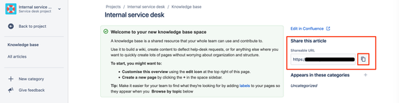

It's possible to add a direct link to an article that will open in the portal and not in Confluence. This link is already ready and you just need to copy. Please, go to the Service Desk project and click on Knowledgebase.
On the next page, you can click on All articles and select the desired article. On the right side, you will see the option to copy the sharable link and this link you can add on the announcement for customers.
Please, give it a try and let us know how it goes.
