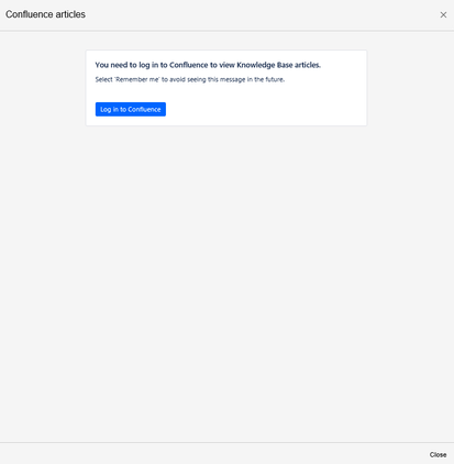

I have created some issues in Service Desk. By going to "Raise a Request" in Jira and searching for an article, I got the Confluence URL.
When posting a comment in the issue, with the URL, a pop up is displayed asking for Confluence login credentials while I am already logged in, in Confluence in another tab.

I tried with a different browser. The same thing happens: When I try to access the Confluence URL I get a "Log in to Confluence" pop up. Even though I am logged in.
