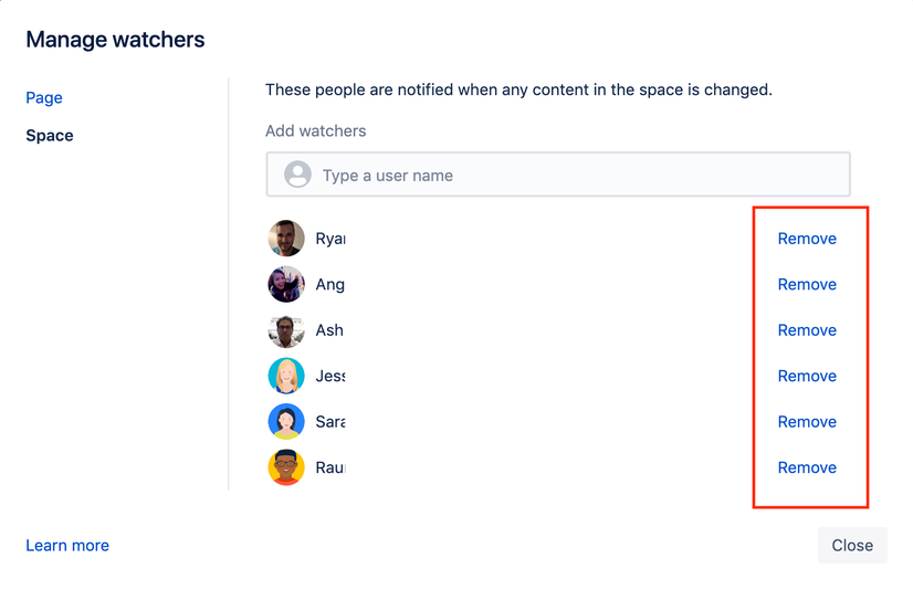

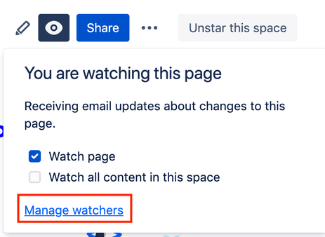

Can you try going to the Space overview page and clicking the eye (watch) icon?
There you should be able to manage space watchers and remove people who are watching the space while you're creating it so they aren't inundated with notifications.
