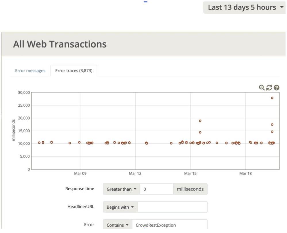

So a few times I heard in one of the installation the problem around the opening Jira, but monitoring shows everything is fine, metrics of response time and TTFB in grafana shows quite good results.
Of course, here helps us with the open source tracing tool Glowroot.

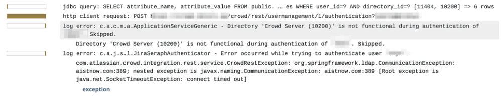

After reviewing the exception, I just set the filter CrowdRestException, to understand the frequency as result I see the time of execution is 10 sec.
After clicking to trace, we can easily find the problem with connection timeout which generates a connection to one of the ldap servers. Which is stuck in the authentication process.
After changing the read timeout to 3 sec, and excluding from AD pool the failing AD server, it works too well.
