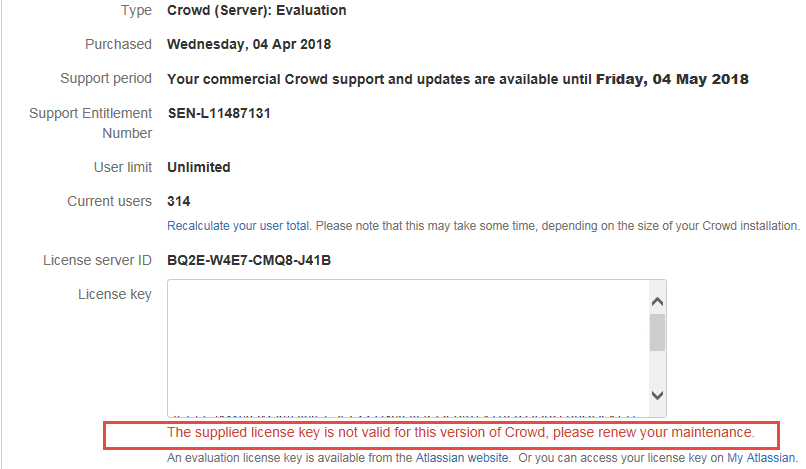

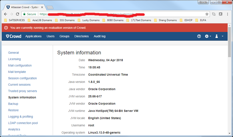

Edmon Uyan April 5, 2018
Hi @Marcin Kempa,
My team was able to upgrade crowd. As it turned out, the new setup states that the maintenance license already expired and that we are running an evaluation version. Any way to allow us to continue using the license of the original setup on this upgraded one?

Marcin Kempa
April 5, 2018
Hi @Edmon Uyan,
That's interesting as this banner should be enabled when the license is evaluation type. Can you double check the license added to this instance?
Hi@Marcin Kempa,
I guess I will not be needing to specify this host header once I upgraded my Crowd to the latest release.
For the license, is it possible to apply the license I had with the previous Crowd deployment?
Edmon Uyan
Marcin Kempa
April 6, 2018
Hi @Edmon Uyan,
Regarding the license for your testing environment you can use a developer license that can be accessed in your license details in https://my.atlassian.com
Best Regards,
Marcin Kempa

Moses Thomas
October 21, 2019
@Marcin Kempa   Hi, I would like to  the disable this  red warning  is  it is  annoying :/ at least  should  be a reminder  to  ask  you  if you  would like to  keep  seeing  this message,  it has been like  that now why red ?
Marcin Kempa
October 24, 2019
Hi @Moses Thomas
Unfortunately it is not possible to disable that in Crowd.
