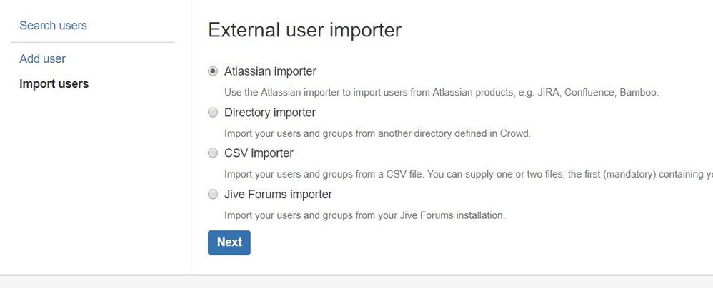

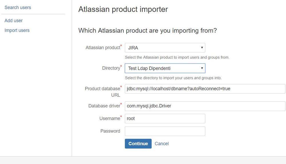

To import ,i select import Users in crowd and passes are shown on picturesCattura.JPGCattura1.JPG

The thing we want is having all groups with users like defined on Jira in our crowd .So we configure LDAP and internal directory for crowd and try to import from Jira. Users and groups are imported but some groups are empty because having users from LDAP.
