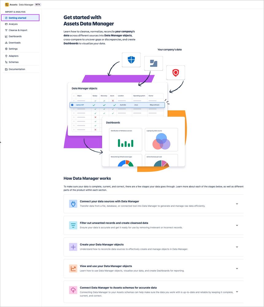

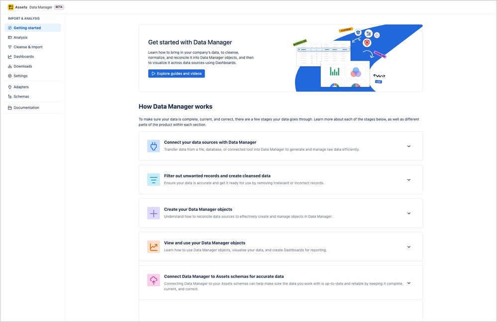

Data Manager in-product Setup Guide
An alternative way to learn how to set up Data Manager is by following the in-product setup guide.
To access the Data Manager in-product guide, simply click on the “Import and Analysis” menu option. From there, you can easily navigate through the various stages to set up Data Manager.
