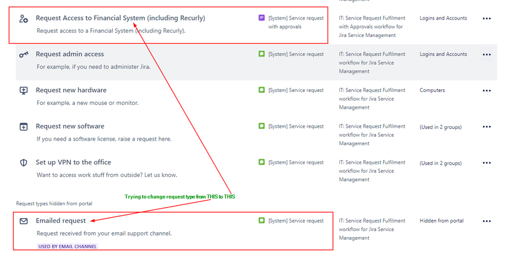

Just getting started with JSM.  Before, all tickets were coming in via email, so I've set up that channel in JSM and will eventually have it watch the mailbox that's currently feeding our old ticket system.
The requests all come in with the "Emailed request" request type, which has the issue type "[System] Service Request".  I created a different Request Type called "Request Access to Financial Systems" which has the issue type "[System] Service request with approvals".
My problem is that if a request comes in via email, I'm not able to change it to my "Request Access to Financial Systems" Request Type, and I'm assuming it's because they're different Issue Types.  But I really need to find a way to do this, so I can collect the approvals needed.  I tried to figure out a way to do this via Automation but ran into the same issue.  Researched a bit and I thought I saw that folks were able to do this via GUI, but I can't figure this out either.
I'm hoping it makes sense and that I used the proper terminology here.  Thanks in advance for any suggestions I'll attach a screenshot showing the two request types I'm referring to.
If there's a better way to accomplish the same goal, I'm all ears.  My goal is to initiate the approval process for any financial system, and not rely on the agent to remember that an approval is needed.  The Request Type I created has that approver baked in.2024-03-08 10_17_25-Tachus IT - Request types - Service project - Jira Service Management.png

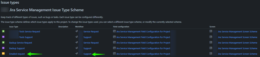

From what I understand, I think the solution that meets your need is to generate a new workflow for that type of requests and associate the "issue type" called "emailed request" to the new workflow.
I have some projects that work that way, all emails received from the client generate a ticket in Jira with the Subject, the Description and an attachment if so, these tickets belong to an "issue type".

here is a screenshot
Mike Gross March 8, 2024
Right now I have email requests coming in properly, I just cannot change the request type to one of a different issue type.  Not all requests coming in via email will require an approval, but some will.  That's why I'm trying to figure out how to choose a request type of a different issue type.
