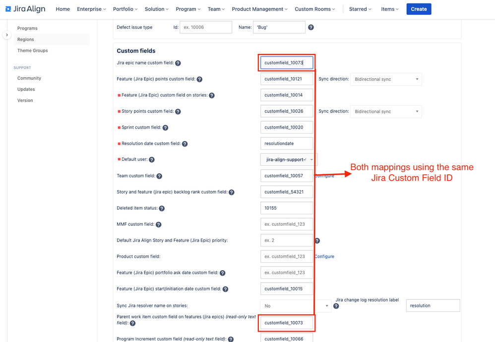

This error can be identified in a Jira Align Issue (Story or Feature) audit log when it tries to sync an Issue to Jira. It basically happens when we have two custom fields mapped with the same Jira Field ID in Jira Align, since it’s not possible to sync two values from Jira Align issue to only one field in Jira it breaks the sync, throws the error in the audit log preventing issues from syncing properly.
To fix the issue you must go to your Jira Align Connector and find and remove the double Jira Custom field Assignment in the Custom Fields area.
Go to Jira Align > Administration or gear Icon right beside your profile picture
Jira Settings > Jira Setup tab
Now in the Custom Fields take a closer look for duplicates customfield_xxxxx mappings, like the example below:
Note: If you don’t find duplicates here take a look in the Field management Tab
Now you have found the duplicate, remove or adjust it according your needs
Hit the Save button at the end of the page
Try to sync your affected issues one more time
