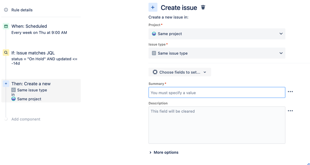

Margareta Buruian
September 9, 2021
Looks like this at a super top level

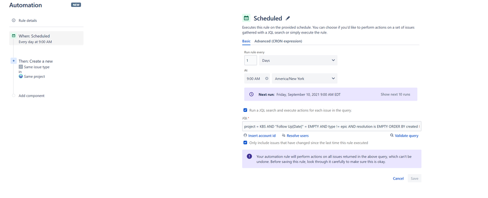

Correct. It wasn't just the issue creation, I also wanted them linked within the issue.
This is the rule that made a new issue for each issue returned.
Mykenna Cepek
September 9, 2021
I notice in your trigger that you have this box checked:
Note how this says that it will execute actions (your "Create issue" component) for each issue in the JQL result.
Have you tried unchecking that box and testing the rule?
Jacob Rosenfeld
September 9, 2021
Then I can't run the JQL and nothing happens.

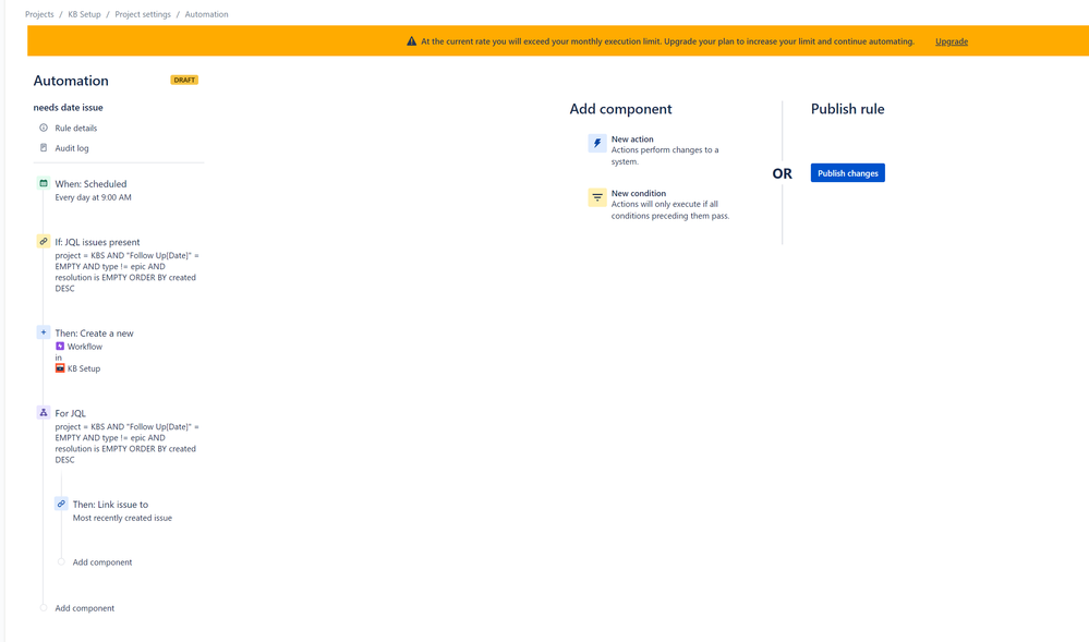

Mykenna Cepek
September 9, 2021
So it seems that using JQL in the Scheduled trigger isn't going to do what you want.
I'm going back to your OP, where you stated:
I want each morning for a new issue to be created linking any tickets that are pulled by this filter...
To run a rule once per day, you do need to use the Schedule trigger. So uncheck the box and skip the JQL in the trigger component of the rule.
Here is some pseudocode for what I suggest for your rule (after the trigger):
1. Terminate early if no issues match your JQL
2. Create a new issue
3. Loop through the JQL and link to the new issue
For part 1, use a JQL Condition with your JQL. If no issue match, the rule will not continue. No new issue will be created (I think this is what you want, right?).
For part 2, use the Create Issue action.
For part 3, start with a Branch / Related Issues component, configured with "Type of related issues" to contain your JQL. In that loop, use the "Link issues" action which allows you specify the "Most recently created issue".

Jacob Rosenfeld
September 9, 2021
Ok, this is what it looks like now and it's working. Thanks!
