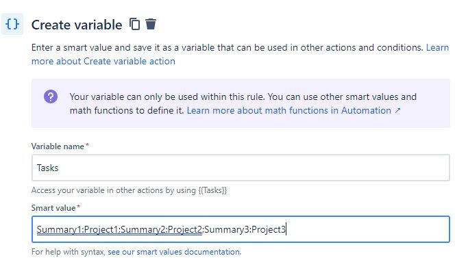

The first step is to create a variable called "Tasks" from a string of Summary/Project. My string format looked like this: "Summary1:Project1;Summary2:Project2;Summary3:Project3" Note that I separate the Summary from the Project by a colon ":" and the Summary:Project set from each other by a semicolon ";". You can use any separator you want. This was just what I chose.2023-09-07_08-11-42.jpg

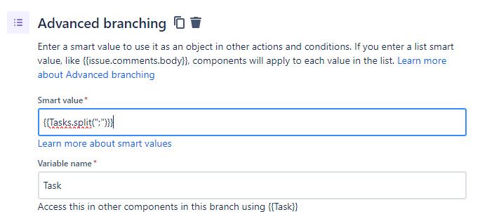

Step 2 is an Advanced Branch in which I loop over the Summary:Project items by passing the smart value {{Tasks.split(";")}} to a new variable that I called "Task" (singular). Now I have the Summary:Project pair in my new variable.

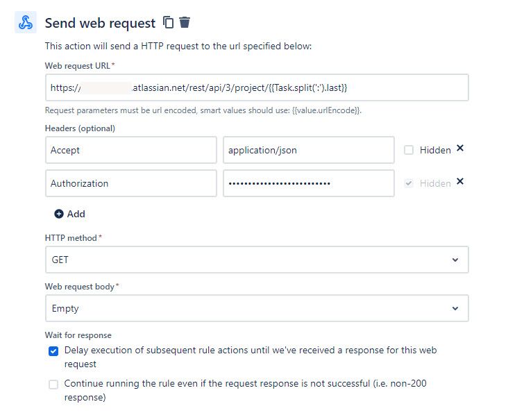

Step 3 is to call a Webhook that returns the Project Id. The URL is <Jira Base>/rest/api/3/project/{{Task.split(':').last}}. Notice the "last" at the end. This splits the Summary:Project into a first and last part. Also, it is essential that you check the "Delay execution..." box so that it waits for the result of the GET call.

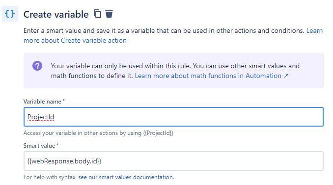

Step 4 is to create a variable called ProjectId from the webResponse that comes back from Step 3. ProjectId is created from {{webResponse.body.id}}, which is the Project Id. It is not required to create this variable as you can access the information directly, but I think it makes the routine somewhat more readable.2023-09-07_08-03-01.jpg

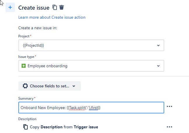

Step 5 is to create the new Issue using the {{ProjectId}} key. I set the Summary to {{Task.split(':').first}}. In my case, I also copy a bunch of fields from the Trigger issue.2023-09-07_08-03-25.jpg

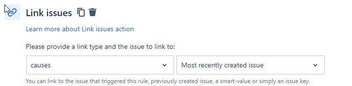

Finally, Step 6 is to link the newly created issue to the original issue. This is straightforward. 2023-09-07_08-03-39.jpg
