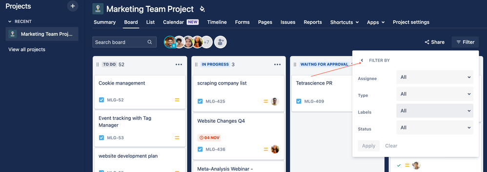

I can see a lot of fields are locked, and I cannot edit the area. The current use case is straightforward. The board admin wants to add a new quick filter column for the team-managed board. But unfortunately, Jira is not providing any option for that. But simultaneously, the existing file (locked one) cannot make any changes.

Hi @Rakesh Gokuldas , locked fields are default/system Jira fields and they cannot be edited. Can you explain what you mean by adding a new quick filter column? Maybe a marked up screenshot? Looking at one of my TMP projects...
Rakesh Gokuldas February 28, 2023
Not this one. Below is the attached quick field I am talking about. The locked one has no option to modify, but the created custom field cannot add to the quick filter. Screenshot 2023-03-01 at 7.53.44 AM.png

You cannot edit that filter feature. However you can create Custom filters under Project settings > Board > Custom filters. You should be able to achieve whatever you want via that method.

Locked fields are locked to prevent us making mistakes like mis-configuring them.  The lock does not stop you creating or amending content in them in issues, and it has nothing to do with filtering (the lock actually prevents you from removing the ability to search on them)
So I am very lost on what your question actually is.
What are you trying to do?   Create a quick filter based on a (locked) field?  Re-configure your columns?  What is the "file" you mention?
I understood about the locked field. But what I am trying to accomplish here is very simple. The attached TM board below has an option ''quick filter'', which only shows very few default fields. The locked field(Category) only has one drop-down to select, and the team wants to add more. For that, I created a new field and added multiple options. But my problem here is I cannot add this new custom field to the quick filter. I hope you got my point. Screenshot 2023-03-01 at 7.53.44 AM.png

So it's nothing to do with locked fields.
You are trying to create a filter based on a custom field?
Is this project a team-managed Jira work management project?  These don't have configurable quick-filters beyond the basic system fields yet.
Rakesh Gokuldas March 1, 2023
It's a pure team-managed board, Nic. Okay, so in this case, I won't be able to add the custom filed to this filter.
