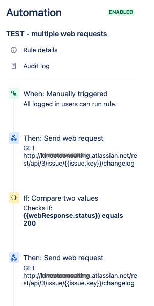

@wojciech_kluszczynski - here is an example of the alternate approach I suggest:
Do not use the "if" component which branches. As @Bill Sheboy noted, branches sometimes execute in parallel (for performance reasons).
By using the "if" component which is in-line instead, things execute in order.
However, I don't actually think it is necessary to check the webResponse.status at all. Note the following configuration available on each "Send web request" component:
In this use case, you would always check the first box, and always leave the second box unchecked. This will ensure that a failed web request will terminate the rule at that point. No additional "if" components are needed.
Curiously, this is also the simplest way to write this rule.

I see. Well, you could try something like this then:
"Box 2" refers to the second checkbox for "continue running ... on non-200 response".
This might get you to 99.94% success rate. Add a third web edit retry to get to one failure every 125,000 attempts (estimated).

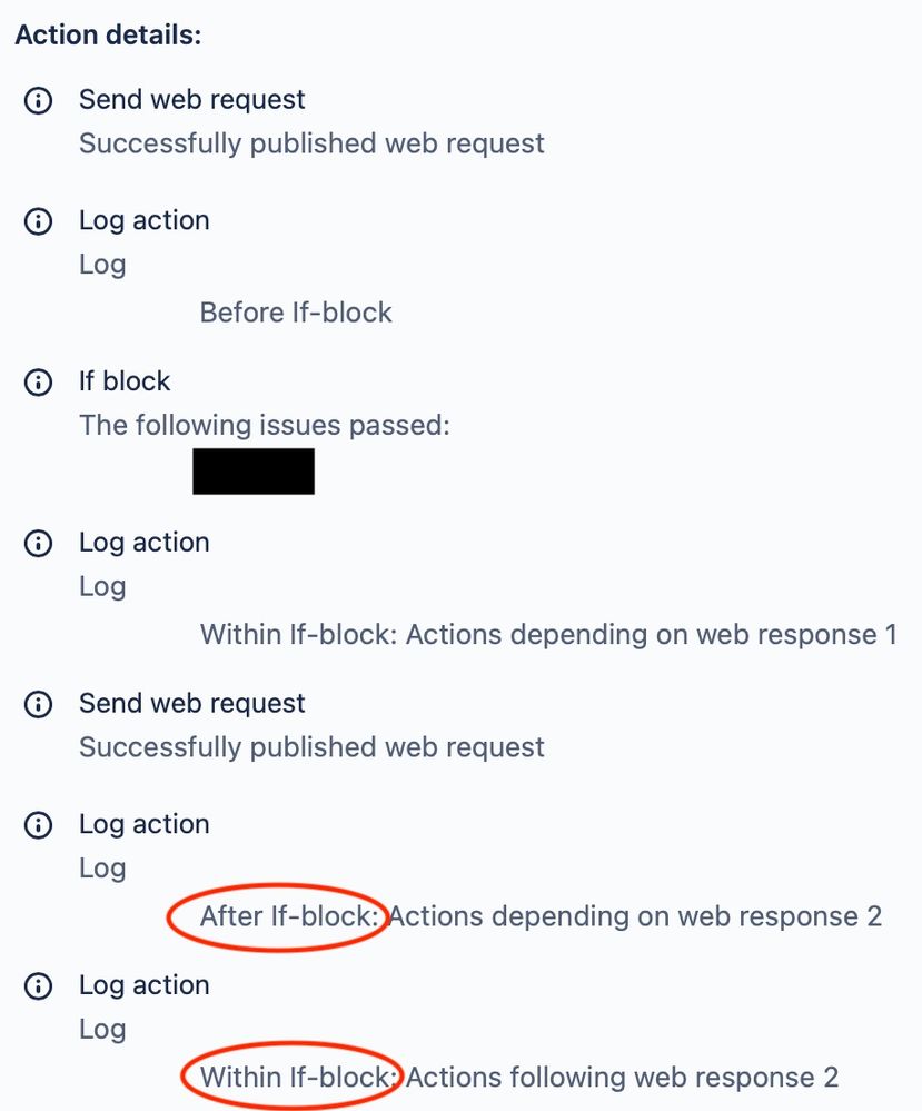

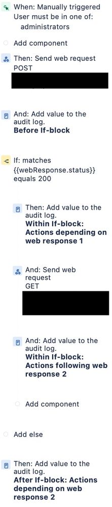

K, I have added screenshots of a base-case rule and audit log. I have also edited the text to replace the confusing "If-branch" terminology with "If-block".
The action after the If-block runs before the remaining actions within the If-block (after the second web request).
This behaviour is highly reproduceable. It does not matter whether the web request succeeds or fails. It does not appear to be an anomaly of the logger (say being asynchronous), since any kind of action gets out of order (not just log actions).
My guess is that the web request fires, spawns a new thread (to wait for the web response), and yields to the main thread, which continues executing (after the If-block).
