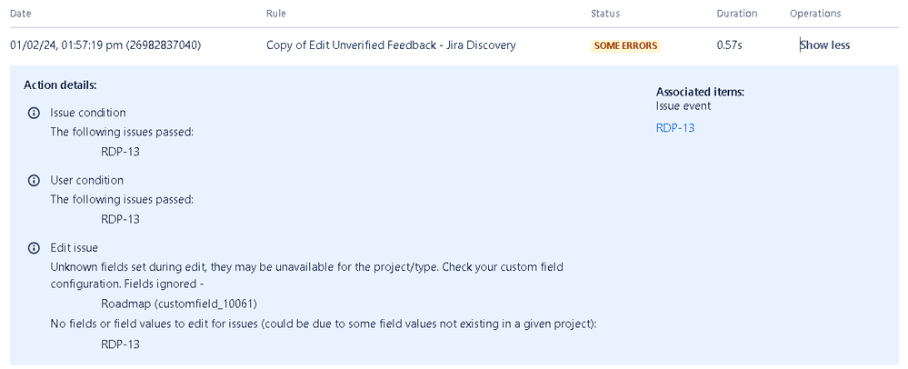

No matter the automation rule setup I try, I always get this error:
Edit issue
Unknown fields set during edit, they may be unavailable for the project/type. Check your custom field configuration. Fields ignored -
Roadmap (customfield_10061)
No fields or field values to edit for issues (could be due to some field values not existing in a given project):
RDP-13
It's not what I want to accomplish but I went for the most basic setup to see if that could work, where I use the standard JDP field 'Roadmap' which is available without Advanced Fields, and i select the value Later
But this also throws the same error.

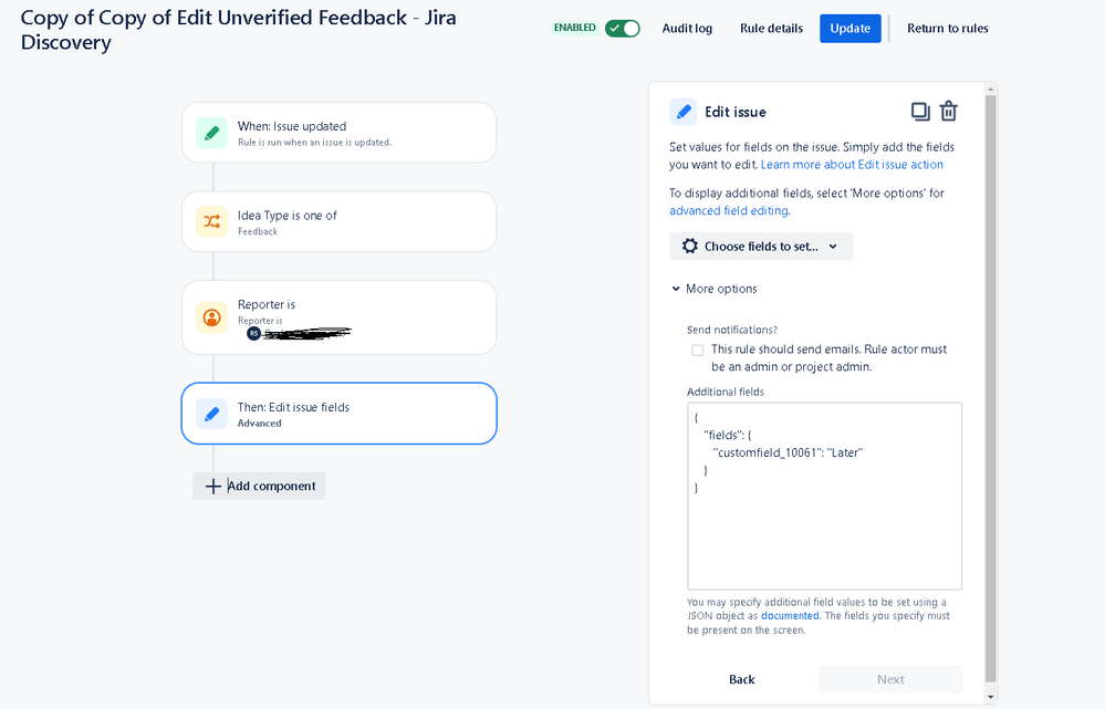

You should add the following JSON to the field that appears when you select "> More options" on the "Edit issue" action. Do not select any field in the "Choose fields to set..." button.
"fields": {
"customfield_10061": "Later"
 Example:
Hope that works - let me know!

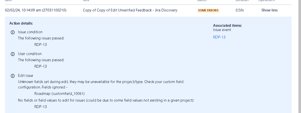

Hi @Mart Postma I still get the same error:
Another member posted a comment that they could select Roadmap and the automation worked for them.
Bug?

@Mart Postma i checked the actor and it was set to Automation for Jira. I don't see a way of changing permissions for this role in JPD. In Jira Software it is set with correct permissions. As a test I changed actor to myself (admin) and the automation gave  a new error - which was due to the advanced code. Using the basic field Roadmap and Later the automation passed.
Do you know if its a bug if Automation for Jira fails as an actor or is there somewhere I can fix the permissions?
For now i'll leave the actor as my own user since that seems to work - thanks.

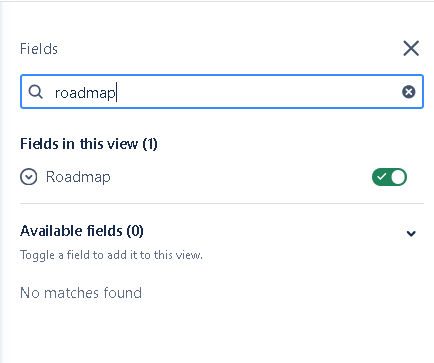

Have you checked your JPD project, and Jira site, to determine if there are multiple fields named Roadmap?
If so, you may need to rename the other one, or use an advanced edit with JSON using the correct custom field id to set the value in this rule:

Hey @Bill Sheboy thanks for the answer.
This is the only roadmap field both in Discovery as Jira Software:

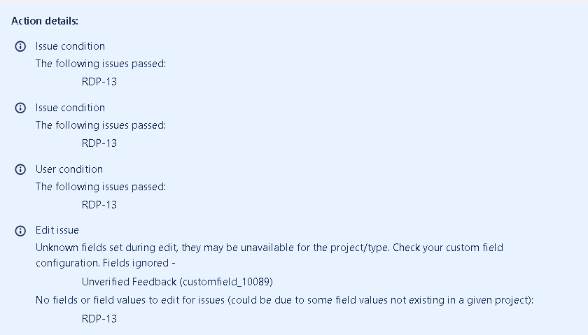

I also have an automation with the same error where I name the exact field:
