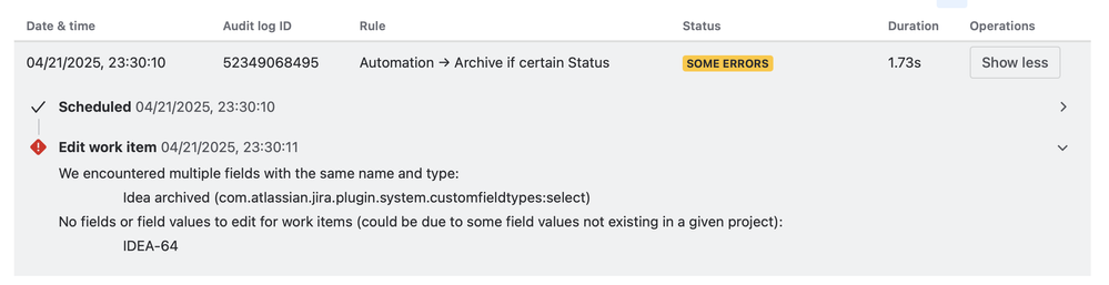

and the validation does work, but the same error appears in the audit log.
So the Audit log shows:
I find the "Idea archived" field in the custom field section, but I have no clue how to find the correct name to add it to my JQL.

My team faced the same issue lately. After working with Atlassian Support, we discovered that this is due to a backend change they're making to migrate the Idea archived field to a single global field, rather than separate project-specific fields. Right now, however, there's both a global field and project fields, so the error you're receiving indicates that automation is unable to determine which one to use.

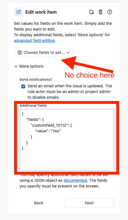

I was successful with 1 and 2 - but for 3, I don't know where to include this information in my automation.
I found the two Custom Fields (customfield_xxxx1 and customfield_xxxx2)
The automation was working, but the issues are still not in the archive.
I tried with both custom fields using it in the "Then" Advanced Section in the Automation as
"fields": {
"customfield_xxxx1": {
"value": "Yes"

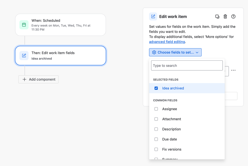

When using a JSON expression to update a field, please note:
Ensure the field is not selected from the dropdown list AND in the JSON expression, as only one may be used at a time for a single Edit Work Item action.

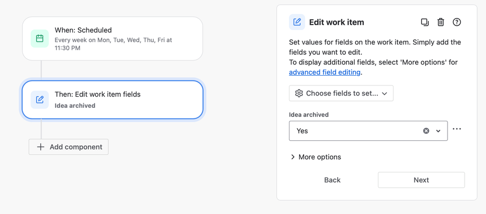

And my Then section is
The JSON finds the right issues and the automation has no error. But the issues are not in the archive.

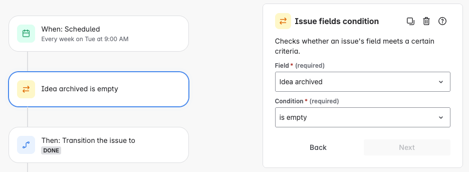

Hi @Dominik,
Does the JQL query work in the issue search view? Switching from basic search to JQL gives me this query:
status IN ("To Do", Done) AND "idea archived[dropdown]" is empty
If the JQL query is buggy, using the "Idea archived is empty" part as a separate condition in your automation should fix the issue:
