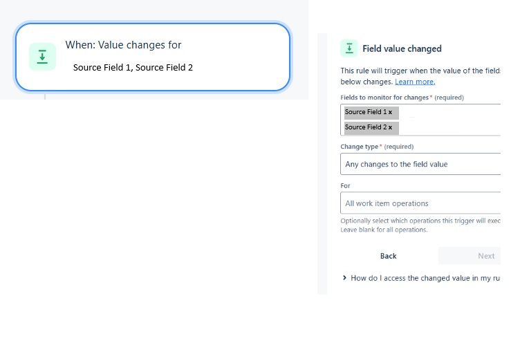

Fiona Lauchlan July 10, 2025
I have created a new destination field. This is set up as a select type, with no data options.
I am now attempting to create a rule.

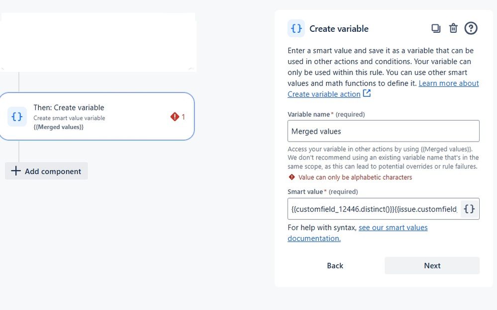

So far I have created a Trigger, for when Value changes on either of the source fields, but any guidance on how to create variable would be appreciated. I attempted to select the two fields from the smart values but receive error in numbers returned

When posting rule images, please post the entire rule in one continuous image and post the relevant actions as separate images.  That will provide overall context for what is happening.
Until we see that...
When creating a rule like this, I recommend writing intermediate results / smart values to the audit log with the Log action to help with debugging the rule.
Please re-read my explanation of how to combine the values and the documentation for the Create Variable action.  As you see on the page, the Variable Name is not valid as it contains spaces, and your merge expression is incorrect.
To get the values for one of the multiple-selection fields, use this.  Please replace the ID numbers with your own value.
{{issue.customfield_12345.value.join(",")}}
Do the same for the other field, concatenating the results, with a comma between them.
Then split() them back apart into a list, and finally use the distinct function:
{{issue.customfield_12345.value.join(",").concat(",").concat(issue.customfield_67890.value.join(",")).split(",").distinct.match("(.++)")}}
Once you have tried and tested that expression, it may be used to create the dynamic JSON.
